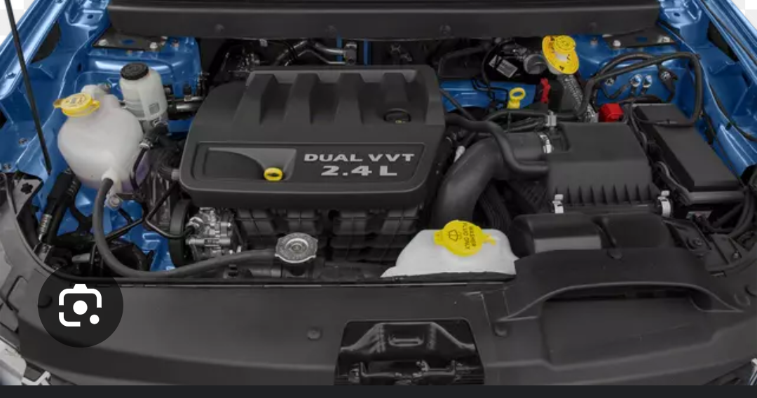

Dean H Posted November 22, 2024 Report Share Posted November 22, 2024 (edited) Specifically , You need to check the coolant level cold and after being driven full hot. You need to learn how the coolant level changes. Then check it daily. While your checking your coolant. Check all your fluids and hoses. Know what is going on under your hood. Before you go driving. Go read this post below, I made regarding maintenance. It's up to you monitor this situation. The Journey's engines cannot take too many overheats. Before it's scrap. Edited November 22, 2024 by Dean H Quote Link to comment Share on other sites More sharing options...

Dean H Posted November 24, 2024 Report Share Posted November 24, 2024 (edited) Glad to hear everything is good with your Journey. Post back anytime. Check the coolant level at both places. When you check the coolant level cold, in the radiator. Check the 2 rubber seals on the cap it's self. If not intact. Replace it. The cap pressurizes your cooling system. Edited November 24, 2024 by Dean H Quote Link to comment Share on other sites More sharing options...
2late4u Posted November 25, 2024 Report Share Posted November 25, 2024 go ahead and check it cold if needed to add some go ahead and add some THEN mark it real good with a black marker at the cold level and then later on after running it normal amount of time and then mark it again after it has set a bit to show the full mark and then check it every day for a couple of weeks and then once a week after that also a good time to check all the other fluids like power steering and brake fluid and the oil level Dean H 1 Quote Link to comment Share on other sites More sharing options...
DodgeBruhBoy Posted December 18, 2024 Author Report Share Posted December 18, 2024 Ok I'm back, the car seems to be overheating when the heat is NOT on, what's interesting is that this didn't happen before. I was driving on the highway and the I noticed the coolant temp got to 226, and then I turned the heat on and it dropped to about 200-206. I have been checking the coolant level daily, and the reservoir level is the same (marked it). But when I opened the radiator cap last night (cold) it was between a quarter of a cup short and half cup low. I'm going into a friends shop to do a pressure test in the next day or two, I'm really hoping not, but I'm possibly suspecting now its a blown head gasket. I did have a vehicle warranty with SilverRock and it should be covered for the most part. Anything else I should check before I take it in? Any thoughts? Quote Link to comment Share on other sites More sharing options...
5rebel9 Posted December 18, 2024 Report Share Posted December 18, 2024 A pressure test of the cooling system would be a good start, and also test the radiator cap {most pressure testers can also check the cap to be sure it is functioning properly also}. Note the thermostat housing {mounted on the transmission end of the cylinder head} is prone to leak as it is PLASTIC with O-ring seal. From your report, I would question that the higher opening temp thermostat is sticking. The car uses TWO different temp thermostats in that housing I speak of and I would suggest your friends shop replace both of them IF they find NO LEAKS. IF you had a bad head gasket it would run poorly and be bowing out coolant and smoke out the exhaust...In short wording, you would see and know something MAJOR like that was happening. High digital temp readings you post of can be from a sticking shut 2nd T-stat, since you post that the temp gage comes back down some with interior heat turned on when the temp gets that high. Good luck and keep in touch! Quote Link to comment Share on other sites More sharing options...
