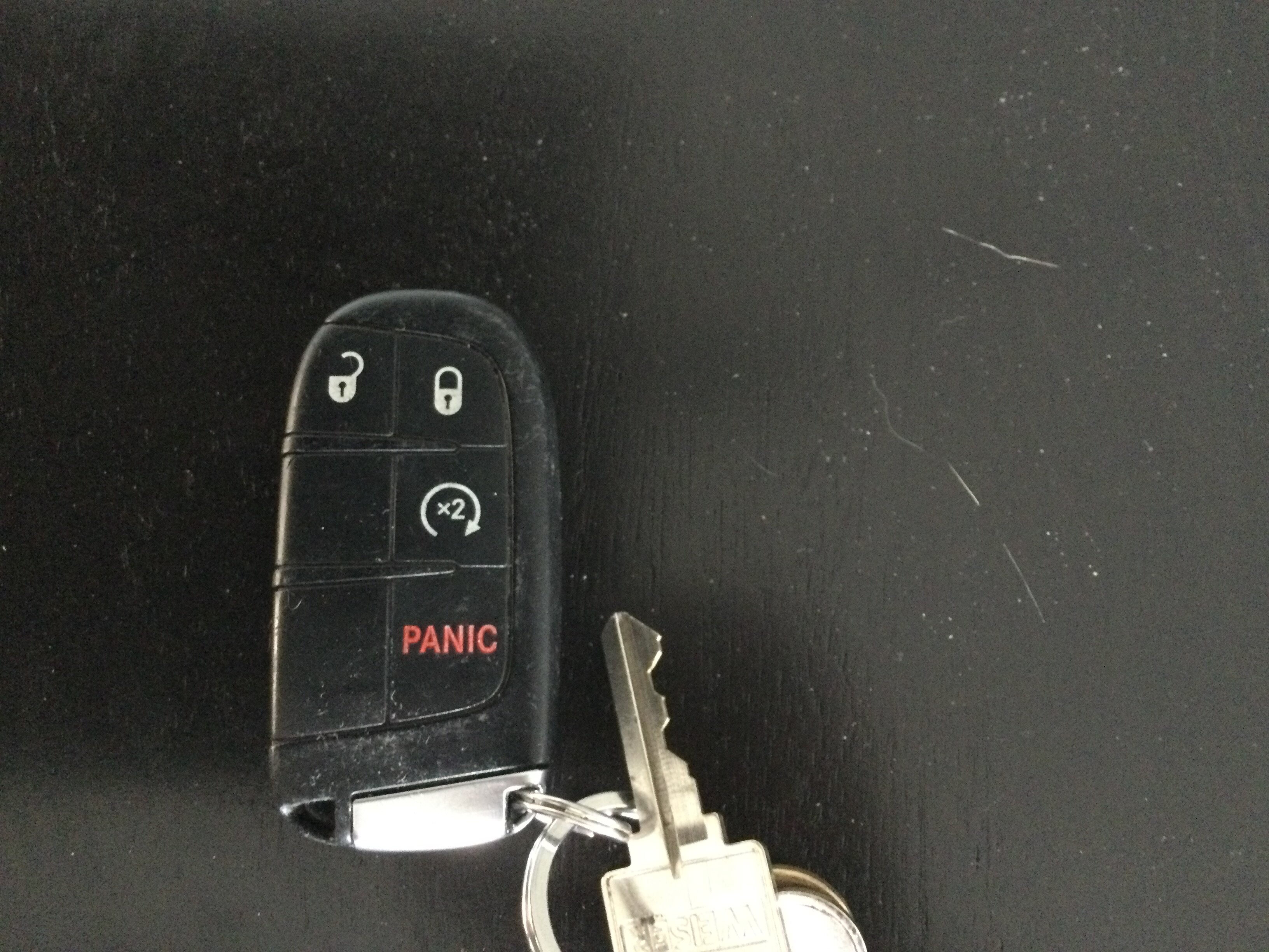

John/Horace Posted January 25 Report Share Posted January 25 Most of the time just alphaobd with scanner can enable. If Sirius radio optioned pretty much guaranteed antenna etc is all there but both remotes programmed by alphaobd still needed. Remote requires an extra button that triggers with double click. Like in pic. It is an old school 315 MHz (unlike Asia and europe who use 433.9 and 868 MHz) set up so range limited to around 100 metres or 330 feet. Still handy to have. Quote Link to comment Share on other sites More sharing options...
5rebel9 Posted January 25 Report Share Posted January 25 A couple of extra things needed for the years the OP is looking for Remote start IS doable , but need to have hood {bonnet} safety switch installed if car is not already so equipped with R.S. Wiring SHOULD already be there. AND 2015 and newer have a Security Gateway Module that takes special hook up harness for alphabob{or similar program} to enable new fobs and activate R.S. in the BCM Quote Link to comment Share on other sites More sharing options...
