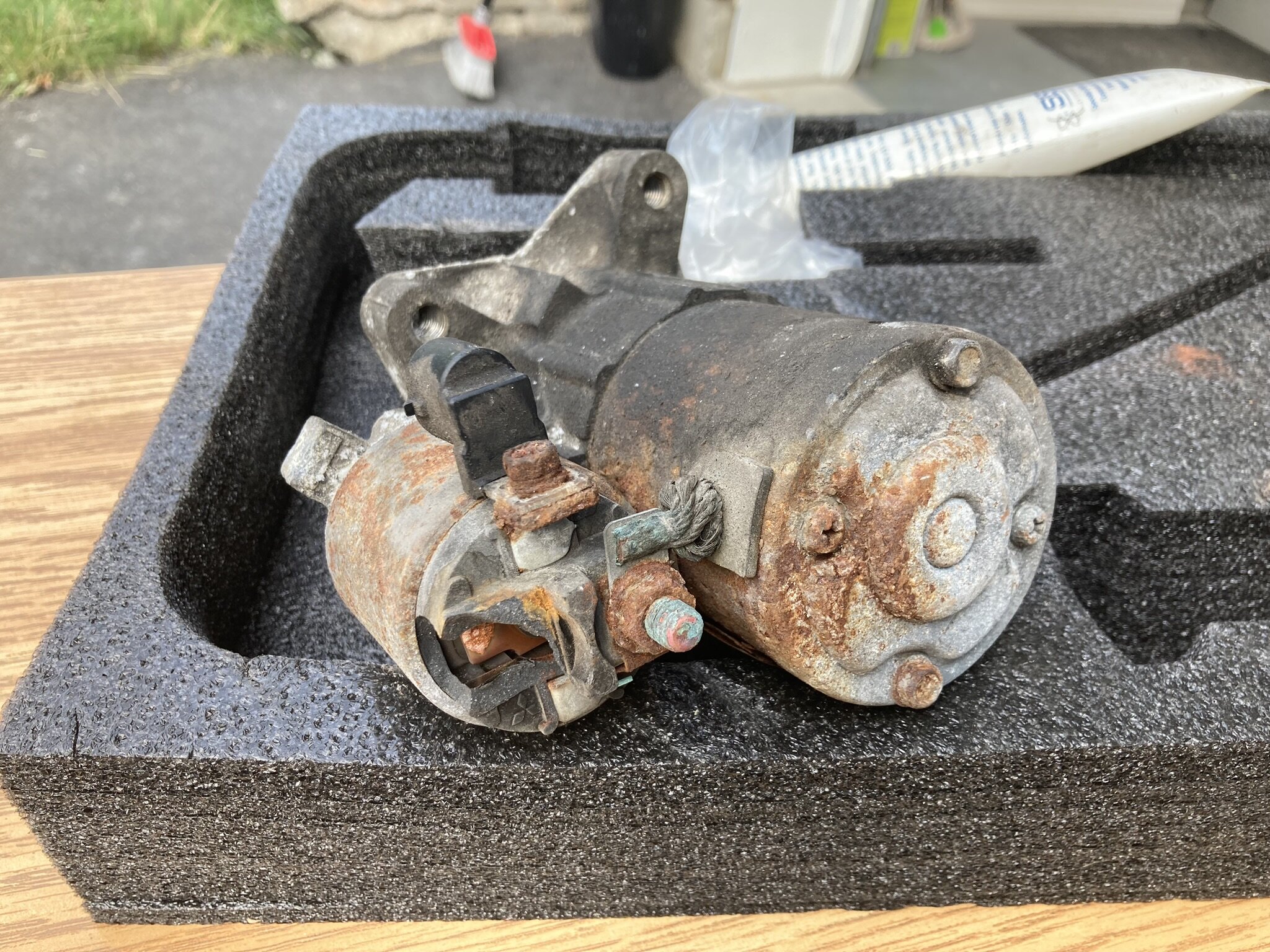

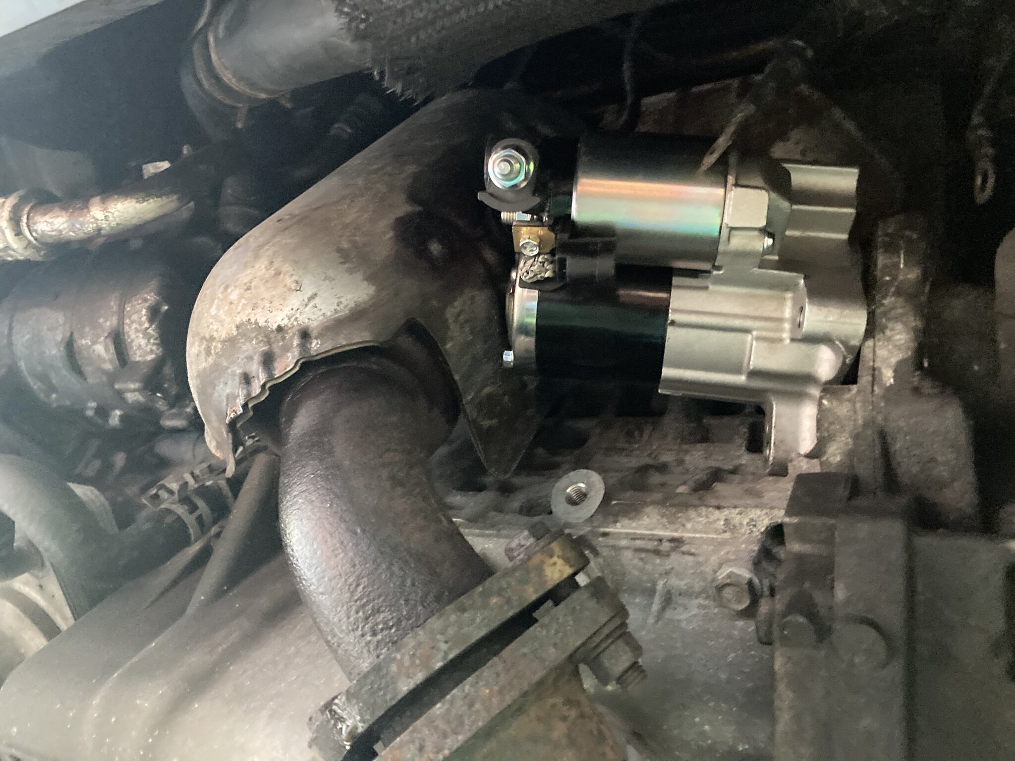

Salah-Belkhodja Abdeslem Posted March 14 Author Report Share Posted March 14 (edited) the original starter was replaced on july 2023 (recently) , the battery is an Energizer (AGM) , i also have installed a battery maintainer under the hood + a battery thermal wrap . i wanna just mention that when it's happen and when we turn the key , we have power on the dash bord , but we dont here nothing when we try to activate the starter, till the engine is completly cold. thanks for your support ! below are the photos of the old and the new starters. Edited March 14 by Salah-Belkhodja Abdeslem grammatical forms Quote Link to comment Share on other sites More sharing options...
John/Horace Posted March 16 Report Share Posted March 16 (edited) Starter probably binding internally when heated up. They can fail like this sometimes. New starter over remanufactured unit is usually better. OEM over cheaper aftermarket even better. Mopar on Journey are often Nipodensa, one of the better manufacturers. Very pricy new. Reman Mopar is available. Could jumper starter relay moving contacts, 85 and 87 when not turning over. If it then turns over, then starter is ok, other issue like park neutral, security system, starter relay, wiring harness etc. Edited March 16 by John/Horace Quote Link to comment Share on other sites More sharing options...
