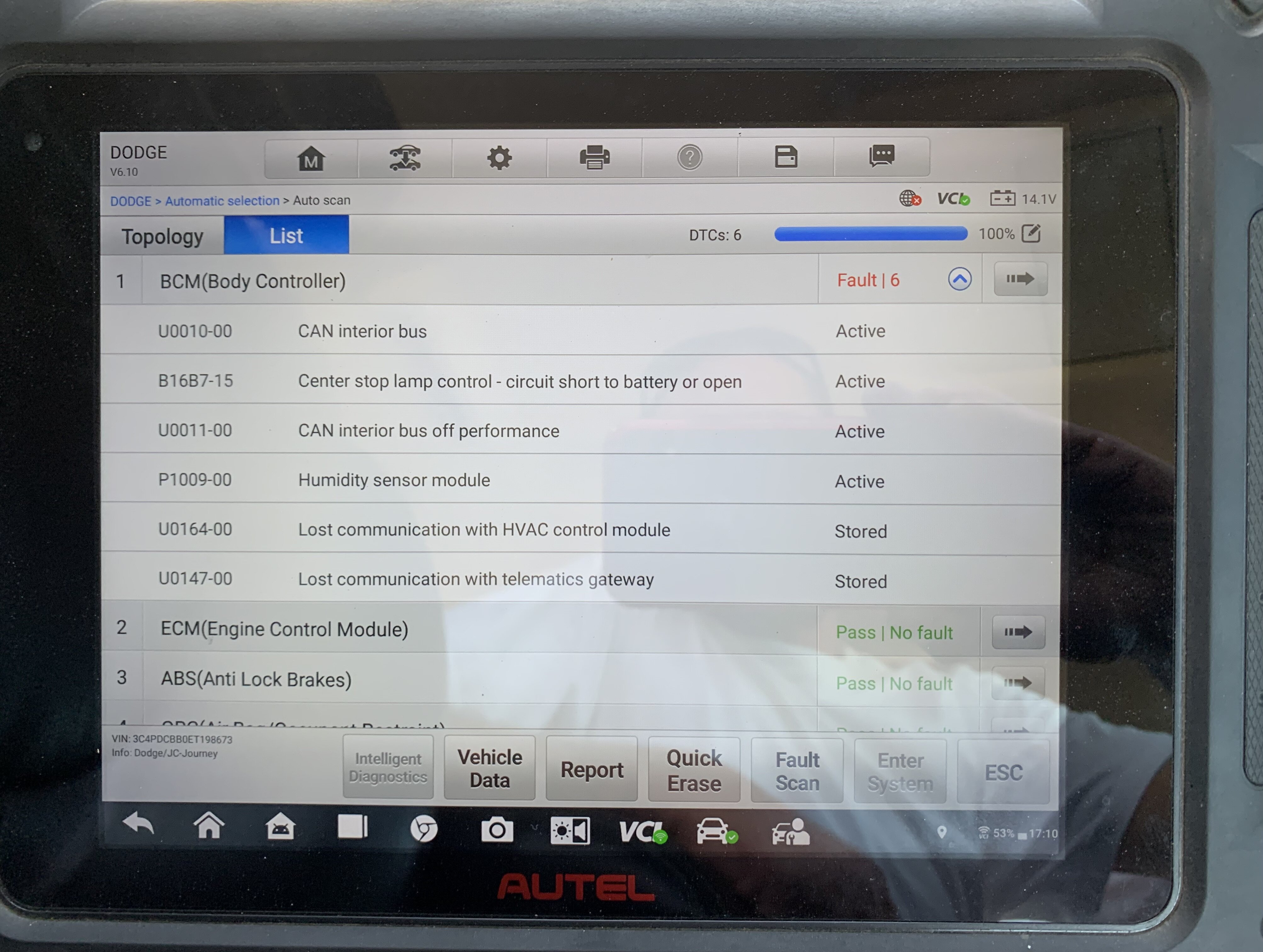

Dean H Posted April 10 Report Share Posted April 10 Did you find any codes on the stock system? Quote Link to comment Share on other sites More sharing options...
COsxt Posted April 10 Author Report Share Posted April 10 Ok. I’ll start with the panel first. It does have the auto feature. As far as checking the codes, the mechanic at my fabrication yard has been out all week and has the scanner locked up with all the other tools. I have a buddy with a really high end snap on scanner that said he could bring it over today. Even with the aftermarket radio installed, the scanner should still be able to see what’s communicating and not communicating correct? I didn’t want the new radio to throw off what the scanner should be seeing and look at it as another potential problem. Thanks for all the responses, they’re a big help! Quote Link to comment Share on other sites More sharing options...

Dean H Posted April 10 Report Share Posted April 10 (edited) Restore the stock Dodge components. See what codes you have. Edited April 10 by Dean H Quote Link to comment Share on other sites More sharing options...
