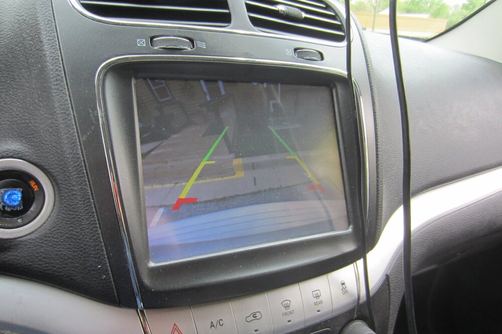

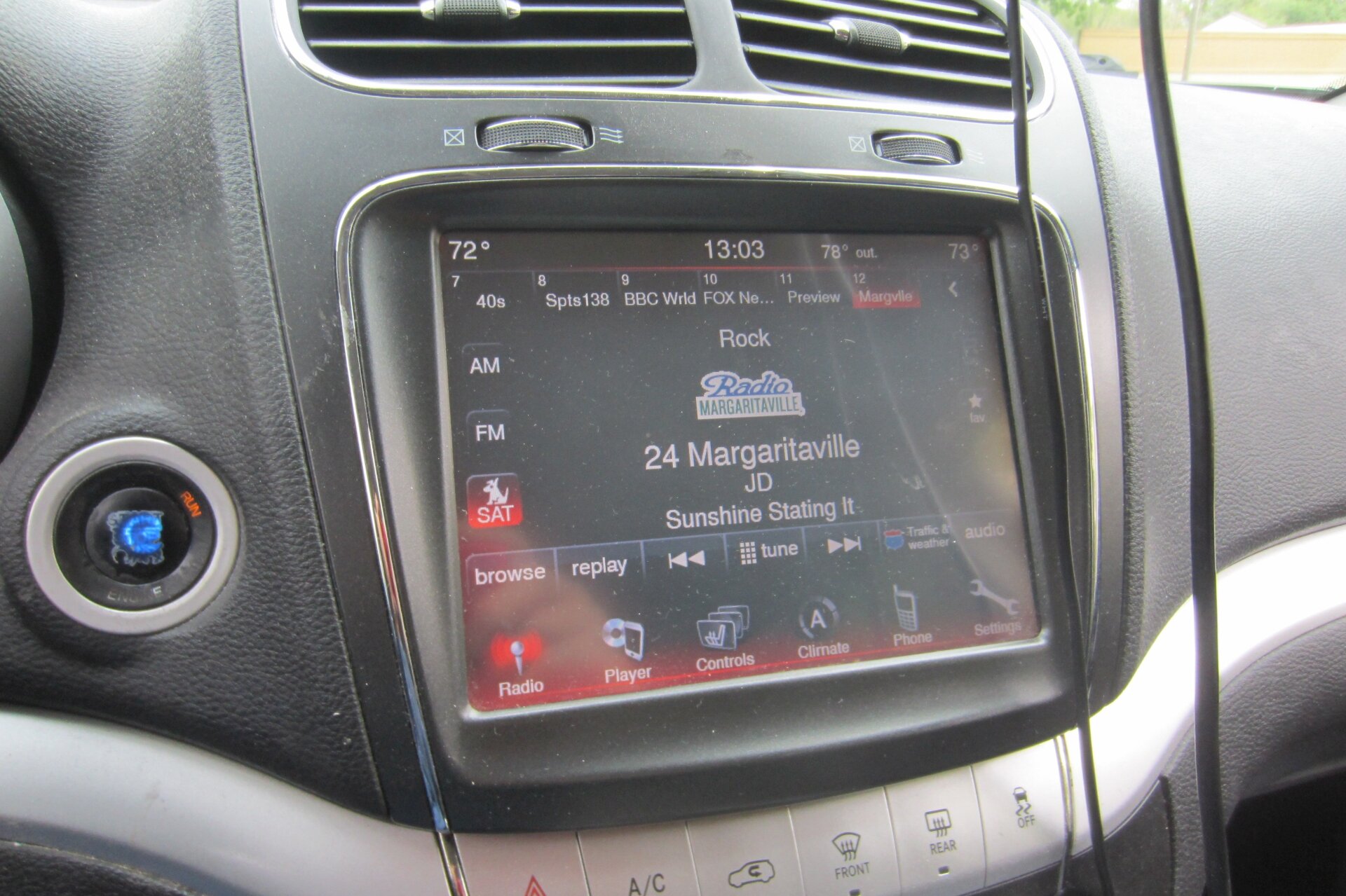

smfabac Posted April 30 Author Report Share Posted April 30 On 4/24/2025 at 5:27 PM, 5rebel9 said: Yes, they ALL do that. it is possible that the interior dimmer control may be going bad causing "dimming out" of both screens as the OP stated as his problem concern. The way he posted{upon re reading his post} leaves me thinking his concern is only during backup camera mode, and thus is more likely to be a camera in the rear hatch problem. I've read of many backup camera concerns here on the forum....of the 4 DJ's in my care NONE has the backup camera feature. Expand Having owned the 2013 since 2015 at 12,000 miles I am aware of the operation of the dimmer switch. Checking the view of the backup camera is not conclusive. If the camera is bad and the image is impacted, then the green, yellow, and red lines superimposed on the camera image would be brighter than the image itself. That is not the case in the attached images. The photos were taken on a cloudy day. Direct sun on sunny days totally washes out the 8x4 display and camera image. Is there a way to access any hidden menus on the 8x4 display? Quote Link to comment Share on other sites More sharing options...
