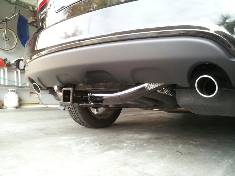

dodgeman324 Posted July 31, 2011 Report Share Posted July 31, 2011 I also installed mine today. My Draw-Tite model came by Fedex this morning, and this afternoon at about 2pm I started the install. Most of my time was getting exhaust hangers undone. I just had shoulder surgery last week so my actual grip strength is decreased which made getting them off more difficult and time consuming, but the WD40 is a definite must when working with those things. As said by several other members, the actual hitch install was pretty easy. My kit came with included wire with perfectly sized threads at end for the carriage bolts for feeding bolt through impact bar, I was impressed that they include those these days. I was expecting to use my own wire methods to prevent bolt loss inside framerails. I went with the Draw-Tite because 1) I didn't want to cut bumper and 2) I already have a ball and ball shank for normal horizontal receiver, therefore, not needing to purchase a vertical receiver shank (is that what it's called). Because of my shoulder, I used a floor jack to lift hitch into position while I threaded on nuts and washers. Putting the exhaust back up went much better than taking off, somehow. Well, here's the pictures of my finished product. Now, I'm just waiting on a Modulite kit in the mail to hopefully get a trailer wiring hookup going. More to follow on that. Quote Link to comment Share on other sites More sharing options...
b1pig Posted July 31, 2011 Report Share Posted July 31, 2011 Thanks for including some pictures. We just got our 2011 Friday. The tow hitch was one of the things I'll hopefully get for it in the future. Quote Link to comment Share on other sites More sharing options...
dodgeman324 Posted July 31, 2011 Report Share Posted July 31, 2011 No problem on the pictures. I took my bumper off which made it much easier to install, but it wasn't required, just fyi. If you go with the Mopar Hitch, you will have to take bumper off and cut into the bumper. I didn't wanna do that. Quote Link to comment Share on other sites More sharing options...
Armendegga Posted July 31, 2011 Author Report Share Posted July 31, 2011 Cutting the bumper isn't actually required. Another user has it completely hidden behind the bumper . I chose to cut mine though, which was pretty easy in itself. The instruction booklet gives you the template to use for cutting. And yep, you're right, with the Mopar hitch, you need to take the bumper off Quote Link to comment Share on other sites More sharing options...

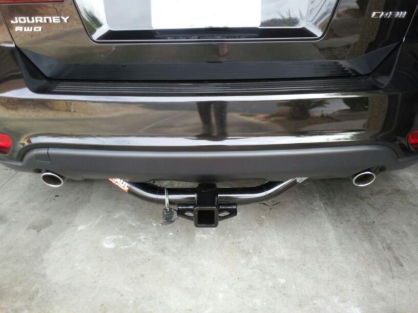

Psyke Posted May 22, 2012 Report Share Posted May 22, 2012 (edited) I really like the looks of the DRAWTITE hitch in this forum and took the picture to the U-Haul hitch dealer near me to see if theirs was as tight and clean. The lead tech told me u-hauls hitches are manufactured by DRAWTITE and will be close to the bumper.... $315 later (nice price) and i'm NOT over joyed about the finished look. I was hoping for a higher, less bulky look like Dodgeman324's.....The only thing i can see is that maybe the 2012 has a slight difference in rear profile with the "stow and go" and spare tire that makes a difference in the hitch....Oh well...... while it might have been made by drawtite, the model dodgeman has and the uhaul model you picked up are definitely different. Dodgeman's has fully straight bars from the mounts to the hitch, while yours are bent bars that drop down from the mount, then angles/curves towards the hitch. I believe I found the model Dodgeman bought here: http://www.etrailer....leid=2012201530 which includes a video for installing it if anyone is interested in doing themselves. I have no plans for hooking up a trailer, but I'm looking to install one of these at one point sans wiring harness just so I can tow bicycles (and realizing I really don't have enough room for even one bike in the trunk with the second row up....) Edited May 22, 2012 by Psyke Quote Link to comment Share on other sites More sharing options...
