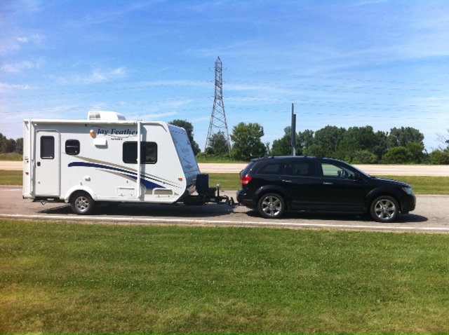

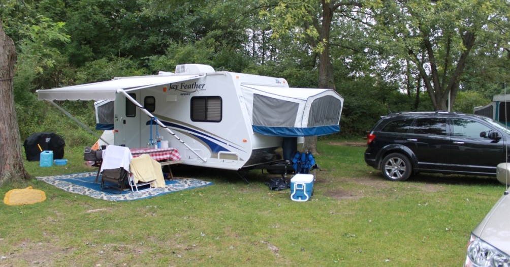

joe8918 Posted March 26, 2012 Report Share Posted March 26, 2012 Hi - it doesn't seem like many people use the full towing capacity of their Journey. I have been utilizing it with great success. I have a 2010MY R/T with towing prep. I installed the Curt hitch. I had a dealer install the 7 pin connector. I'm towing a 2011MY Jayco X17Z. I have a Prodigy brake controller and an Equalizer hitch. We took it on 4 different camping trips last year and had a great time. The fuel economy really is decreased as I only get 11.4 MPG but that's what you get when you tow like this. I only drive 60MPH and never go into 6th gear. If its really hilly terrain I have to rarely put it in 4th. I will post pics from another post. Joe Quote Link to comment Share on other sites More sharing options...
joe8918 Posted March 26, 2012 Author Report Share Posted March 26, 2012 Attached are the pics Quote Link to comment Share on other sites More sharing options...

Jay Sixspeedrt Posted March 27, 2012 Report Share Posted March 27, 2012 According to Jayco's website, dry weight is 3120 lbs and 415 lb hitch weight. Of course, fill the trailer with food, cookware, clothing, toys, potable water, etc. and the weight will go up fast. 83 gallons of onboard tanks = 690 more lbs if full. Obviously pushing 4000 lbs. Fully loaded, my boat is about 3000 lbs - I'll be picking up from winter storage in a few weeks. I'll post some photos then. Quote Link to comment Share on other sites More sharing options...
joe8918 Posted March 29, 2012 Author Report Share Posted March 29, 2012 The Jayco website you see if for the 2012MY which is slightly higher. RV manufacturer's normally put the "off the line" weight on their sites and literature. What you need to look at is the sticker on the RV entry door. Mine says that it is 3094lbs. The hitch weight is something which is also something that "on paper" is unknown. I have a weight distribution system so my rear end is not seeing all 400 lbs obviously because some of that weight is distributed to the front my vehicle and the back of the trailer. That being said, I'm assuming I'm around 300 lbs trailer hitch weight with my WD system (Equalizer). As I said, I am pushing the "limit", however, what is important to know when towing is what is your GCWR (Gross Combined Weight Rating) of the tow vehicle. The 2010 Journey is 8300 lbs or something like that (I have done the math this hasn't been a shot in the dark). I took the GCWR, the journey curb weight/passengers, trailer data, expected contents of trailer, and I am still thinking I'm fine. I did a "test pull" with an RV dealer to ensure that I'm not doing something foolish. You definatly know that you're pulling it but I baby the Journey when it's pulling. Let me know if anyone else has questions. Quote Link to comment Share on other sites More sharing options...
