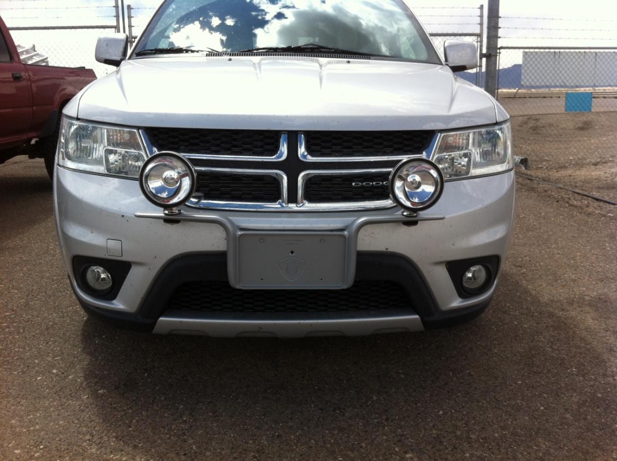

Fdavey55 Posted April 23, 2012 Report Share Posted April 23, 2012 My family is pretty active in the outdoors and quite often we find ourselves out in the middle of nowhere, in the dark. I come from Alaska and with our long dark winters I have always been a fan of “more light”. I wanted to add some off road lights to our DJ but wanted to do it in a way they can be easily removed when not needed. I used a product many years ago called a Carr Light Wing. I ordered one recently and installed it along with two KC lights on our 2012 SXT. Below you will find a picture of the lights installed. I’ve left the license plate off so you can see how easy installation and removal is. The light wing mounts with two screws. I opted for longer bolts that way I could beef it up to minimize light vibration. When I decide to remove it all I’ll need is to take the wing off and unplug the lights. The lights are plugged in behind and below the grill do it looks prettier, lol. To run the power I used a relay system. I installed a switch in the cab right next to where the old dimmer switch used to be. When the switch is in the on position, the lights will turn on when the high beams do. The lights themselves are powered off the battery on their own circuit. I tapped into the high beams just to power the relay. I went this route so the TIPM will never have an unexpected current flow. Psyke 1 Quote Link to comment Share on other sites More sharing options...
Fdavey55 Posted April 23, 2012 Author Report Share Posted April 23, 2012 Here is a view of the distance from the lights to the vehicle. It was also important to me that the lights don't touch or rub our DJ. Macoperator and AaronC 2 Quote Link to comment Share on other sites More sharing options...
Psyke Posted April 24, 2012 Report Share Posted April 24, 2012 Looks nice, but couldn't you run the cable down the mount and through the lower grill. Would look a little cleaner that way. Quote Link to comment Share on other sites More sharing options...
Fdavey55 Posted April 24, 2012 Author Report Share Posted April 24, 2012 I was infact looking at that last night. This weekend I am doing just that, thanks for the feedback! Quote Link to comment Share on other sites More sharing options...

paxmaster2000 Posted January 27, 2013 Report Share Posted January 27, 2013 how did you tap into for the power source? i am thinking of putting some in. i was thinking of just tapping into my parking lights. Quote Link to comment Share on other sites More sharing options...
Deckster Posted April 5, 2013 Report Share Posted April 5, 2013 How did you get the harness through the firewall? I am trying to hook up some lights using the same mount. I have a 2010 R/T and can't find a grommet to pass the switch wiring through. The LED lights I purchased are easy to hook up, but I can't power up the relay using the high beam circuit (without modifying the harness; voiding the warranty) so I have to run the lights manually. I can't even find a decent spot on the dash to mount the switch. Quote Link to comment Share on other sites More sharing options...
