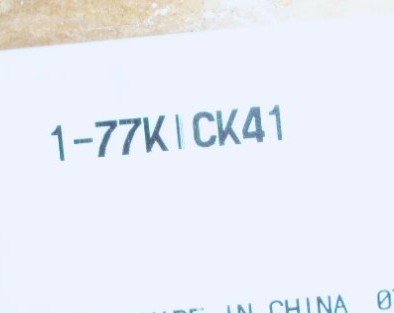

dolphinsrule65 Posted May 17, 2012 Report Share Posted May 17, 2012 (edited) Mopar/Kicker speaker upgraded has been completed in the rear doors so far. (front system has been ordered) Just so everone knows, yes Kicker makes a upgrade for the Journey AVP,SE,SXT with stock 6 speakers, but for some reason(Alpine????) they dont seem to advertise it or want anyone to know. If you write to Kicker like I did,they will also give you the same Mopar part number. 77KICK41 is the part number for the rear doors...they are 6x9's....same kit used in most all Chrysler cars...as a matter of fact, when we took off the stock base speaker, it has the same part number stamped on it that were in my 2011 Ram 1500 when i replaced them with this same kit! After much fussing with the door, we got it off...hint, the door handle trim plate pops off and there are two screws there to remove, then the door comes...need to lift it up to get off..not as easy as it may seem...slow n steady best approach. I HIGHLY recommed spending the $10 for the door removal tool, it is plastic and works perfectly and you do not damage anything....ie: paint.. As you can see by the pictures it is a direct fit...and the sound is so much better. I have used the Mopar/Kicker upgrade kits in my 2007 300SRT8,2008 Sebring Conv't and 2011 Ram 1500 reg cab. So being famalier with them, i personally like them.The nice thing is that the Dodge wire connector is already attached and you just plug it in... Will give some pictures and update when the front kit comes in.. Edited May 18, 2012 by dolphinsrule65 dirceuximenes 1 Quote Link to comment Share on other sites More sharing options...
drb227 Posted May 17, 2012 Report Share Posted May 17, 2012 I'm very interested in this. I have the Alpine system in my 2011 Crew. Where did you actually order this from and what was the cost? Any option to upgrade the subwoofer as well? Quote Link to comment Share on other sites More sharing options...
dolphinsrule65 Posted May 18, 2012 Author Report Share Posted May 18, 2012 (edited) I ordered the Dodge part #77KICK41 kit from my local Dodge dealer(the dealer may ask you for your VIN # and then tell you it does not fit your car, but it does) or EBAY. Most Dodge dealers do not have it in stock and have to order it in. You can also goto www.kicker.com and goto the contacts and ask them for the kit numbers for the "upgraded" system. Also on Kicker's website there is a Mopar tab and there is a chart with ALL the part numbers listed for all the Chrysler/Dodge/Jeep/Ram vehicles. This is the guy who helped me at kicker, the part numbers may or may not be the same for the Alpine system replacements. Brett Nicely Product Specialist bnicely@kicker.com 405.624.8510 ext.7527 Edited May 18, 2012 by dolphinsrule65 Quote Link to comment Share on other sites More sharing options...

RCman Posted May 8, 2016 Report Share Posted May 8, 2016 Hi guys, I just finished installing my new speakers today! I installed the Mopar/Kicker 77KICK28ab (component) in the front doors and dash and the 77KICK41 (coaxial) in the rear doors without any mods at all. The depth of the speakers weren't as deep as the info in all my research and they all fit like they were made for my car and they have the same OEM connector as the original featherweight speakers. The sound difference is definitely huge and I'm hearing more details in my music again. I haven't cranked the volume yet since I heard new speakers should be given a couple days of lower volume for breaking them in. I don't know if that's true or not but I figured it couldn't hurt to go easy on them in the beginning anyway and I don't want to chance damaging them. Mrgixxer6, dhh3, R4V3N and 1 other 4 Quote Link to comment Share on other sites More sharing options...
