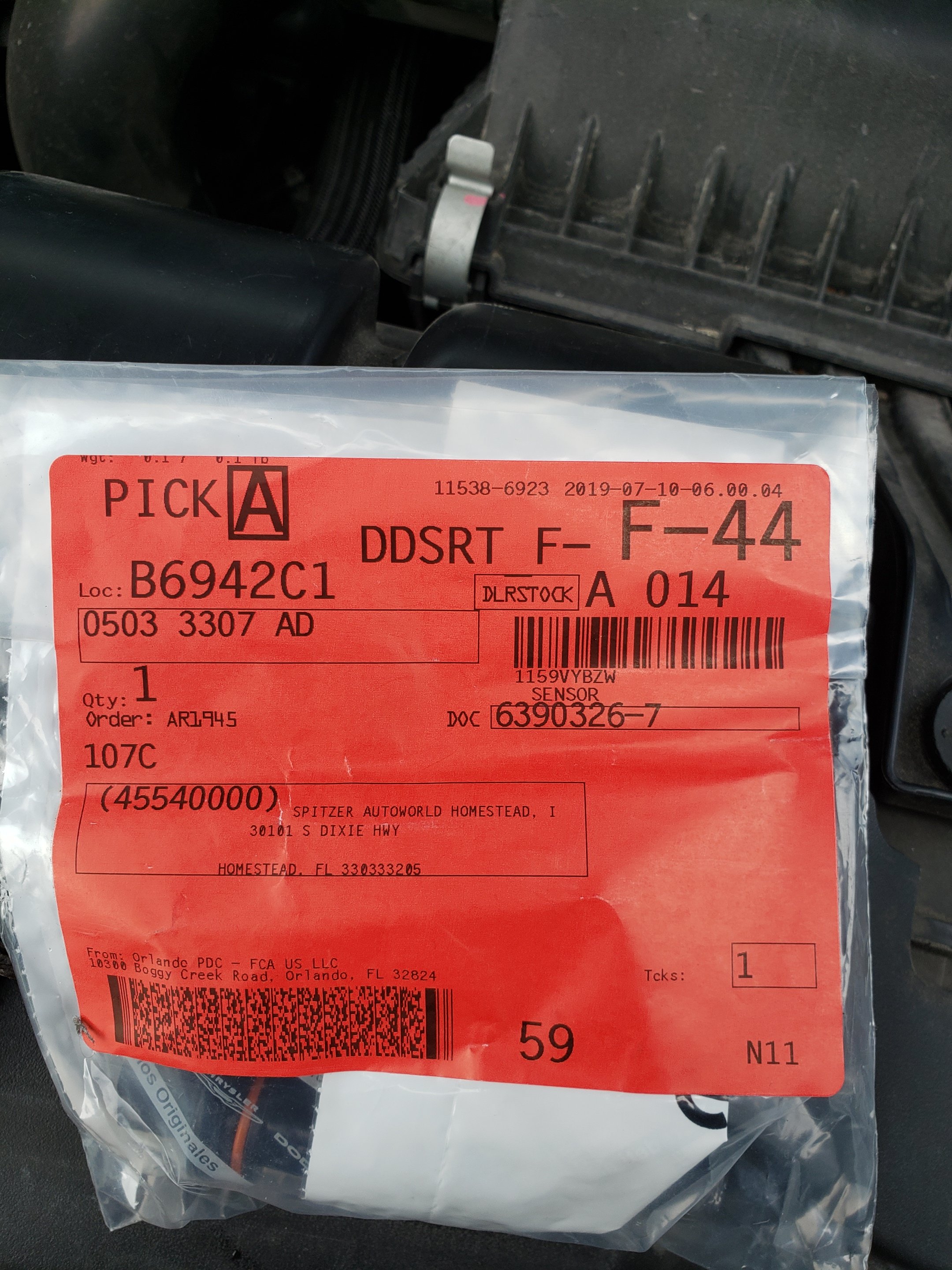

kimeo1978 Posted August 26, 2019 Report Share Posted August 26, 2019 I had this same exact issue and it was very frustrating. My solution to stop the vehicle from shutting down mid traffic was looking at the dodge vehicle recall # S89. I changed my crankshaft sensor on it worked. No more shutting down. Hope this helps jkeaton 1 Quote Link to comment Share on other sites More sharing options...
redtomatoman Posted August 27, 2019 Report Share Posted August 27, 2019 Can you post a link to the dodge recall #S89? Is the crankshaft position sensor easy or difficult to replace? Peace. Quote Link to comment Share on other sites More sharing options...
2late4u Posted August 27, 2019 Report Share Posted August 27, 2019 S89 - Crankshaft Sensor May Fail Causing Engine Stall - 2016 Dodge Journey, Jeep Compass, & Jeep Patriot oemdtc December 29, 2016 Recalls NHTSA Campaign Number: 16V907 Manufacturer Chrysler (FCA US LLC) Components ENGINE AND ENGINE COOLING Potential Number of Units Affected 43,071 Crankshaft Sensor May Fail Causing Engine Stall If the engine stalls, there is an increased the risk of a crash. Summary Chrysler (FCA US LLC) is recalling certain model year 2016 Dodge Journey, Jeep Compass, and Jeep Patriot vehicles manufactured May 9, 2016, to July 15, 2016. The crankshaft or camshaft sensor may only work intermittently, causing the engine to stall.............................................................................................................................................................................................found this by google they say the crankshaft senor is towards the rear by the trans Quote Link to comment Share on other sites More sharing options...
