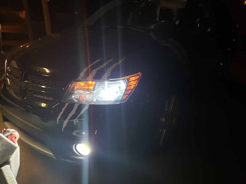

Swapped headlights and fog lights to led, and I'll be doing the custom magnaflow exhaust in a day or two. Cars just awesome. I think I detect a difference in the electric powering settings at speed as well. Feels much firmer than a lot of the others I've driven over the years.
