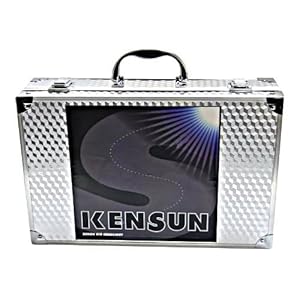

The next kit was listed for my Journey but is no longer available(?) which makes me worry a little bit.
"Slim" HID Kit by Kensun with Xenon Lights, H3, 5000K"
http://www.amazon.co...ils_o02_s01_i00
Both should arrive today or tomorrow.
Installation of the HID kit looks to be straightforward and the new fog light housings looks to be an exact swap.
