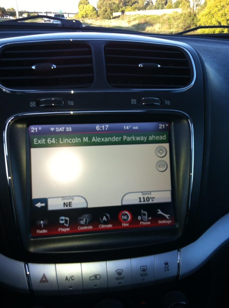

air1rfc Posted January 12, 2013 Report Share Posted January 12, 2013 Double07 I too have the same problem from time to time with the navigation on the 8.4 system. The symptom is that the nav sceen only shows tan. You will see the Street at the top, the direction in the bottom left. In the bottom right the speed is all there as normal. The top and bottom items work as they should and will change as the car drives. You have no blue triangle for your vehicle and no map. When this happens to me it seems that it happens when the system is booting into maps. So after a car start or when switching to maps. The fix for me has been either: 1. Shut off the vehicle. You need to wait until the dash lights and everything go out before the restart. 2. I have had success with switching between climate wait a minute then go into map. It reboots maps at that point for me. I can tell if it worked when I see the Garmin image, then I know it is rebooting. Item two the Climate button is the only button that seems to work for me. The others do not help. I do have a picture of the screen in the no maps state. Quote Link to comment Share on other sites More sharing options...
doubleO7 Posted January 12, 2013 Author Report Share Posted January 12, 2013 Double07I too have the same problem from time to time with the navigation on the 8.4 system. The symptom is that the nav sceen only shows tan. You will see the Street at the top, the direction in the bottom left. In the bottom right the speed is all there as normal. The top and bottom items work as they should and will change as the car drives. You have no blue triangle for your vehicle and no map. When this happens to me it seems that it happens when the system is booting into maps. So after a car start or when switching to maps. The fix for me has been either: 1. Shut off the vehicle. You need to wait until the dash lights and everything go out before the restart. 2. I have had success with switching between climate wait a minute then go into map. It reboots maps at that point for me. I can tell if it worked when I see the Garmin image, then I know it is rebooting. Item two the Climate button is the only button that seems to work for me. The others do not help. I do have a picture of the screen in the no maps state.image.jpg Thats what my screen looks like also. Have you taken your Journey into the dealer to have it looked at, or at least get it on record that this problem exists while the vehicle is under warranty? Out of curiosity, what is the build date on your vehicle. Mine is May 2012. I have seen where TSBs sometimes are for certain build dates. Could be a problem that only exists for a few vehciles between certian build dates, therefore not a widespread problem. This may give DodgeCares and DodgeCaCares some more info to go on. Quote Link to comment Share on other sites More sharing options...
air1rfc Posted January 13, 2013 Report Share Posted January 13, 2013 I have not had it to the dealer for this issue. It would hard to duplicate at he dealer since it is intermittent. But I did get the picture to prove it happens. Just so they don't think I am nuts when I do go in. I will let them know at my next visit. My build date was February 13 2012 according to the dealer. So a few months before yours. Hopefully the picture helps DodgeCares or DodgeCaCares understand the problem better.. Quote Link to comment Share on other sites More sharing options...
doubleO7 Posted February 18, 2013 Author Report Share Posted February 18, 2013 I have not had it to the dealer for this issue. It would hard to duplicate at he dealer since it is intermittent. But I did get the picture to prove it happens. Just so they don't think I am nuts when I do go in. I will let them know at my next visit.My build date was February 13 2012 according to the dealer. So a few months before yours. Hopefully the picture helps DodgeCares or DodgeCaCares understand the problem better.. I used your idea about taking a photo of the problem as it happened again last week. I had Mrs DoubleO7 in the vehicle with me and she took photos with her I-phone. I had to exit the freeway and shut the vehicle off as nothing seemed to work in getting the problem to self correct. The next day, I printed the photos and took them into the dealer. My service rep took one look and talked to someone and now a part (sorry I can't remember what part it is) has been ordered. When I take my vehicle in for servicing on the 28th, they will have the part and hopefully problem solved. Will keep you informed. sirLIO 1 Quote Link to comment Share on other sites More sharing options...
Official Dodge Support DodgeCares Posted February 18, 2013 Official Dodge Support Report Share Posted February 18, 2013 I used your idea about taking a photo of the problem as it happened again last week. I had Mrs DoubleO7 in the vehicle with me and she took photos with her I-phone. I had to exit the freeway and shut the vehicle off as nothing seemed to work in getting the problem to self correct.The next day, I printed the photos and took them into the dealer. My service rep took one look and talked to someone and now a part (sorry I can't remember what part it is) has been ordered. When I take my vehicle in for servicing on the 28th, they will have the part and hopefully problem solved. Will keep you informed. Yes, please let us know what the part is and if it worked. Thanks... Quote Link to comment Share on other sites More sharing options...
doubleO7 Posted March 1, 2013 Author Report Share Posted March 1, 2013 Today I had the Gateway Module replaced. This is essentially the part the controls the radio and navigation. So, I get into the vehicle and bring up the map. First message I see is that the maps are out of date as they are a year old. Looks like the unit that they obtained has been sitting around for awhile. No big deal, there is a lot of construction on our freeways where I live, so the map will have to be updated eventually, but I will wait a couple of years, as the construction won't be finished until later this year. I have a older Garmin portable unit with lifetime updates, so when I see it has the new interchanges on it, there is no sense in wasting money on an update before then. After, I select remind me in a year the map comes up. Everything looks OK, all the streets (main roads and side streets) are there. When I pull out of the dealership lot, the auto headlights come on and the screen dims. So far so good, streets still showing. About a half of a kilometer (just over half a mile), I make a right hand turn. As the map is adjusting to the new direction, it zooms out and I loose all the streets except for two, the one I just turned off of and the freeway which is about 5 kilometers away (about 3 miles). OK, so I turn the auto dim feature off, and the screen comes up bright again but still no streets. I head back to the dealership, leave the vehicle running and go in and get the service advisor to come and take a look. He tells me, I have to give it some time to reset itself. He turns the vehicle off adn then back on. We go and adjust the setting for more detail. Everything appears OK again. He then states that it takes time for the GPS to work properly as its a new unit. I'm thinking to myself "but the maps are already on the unit, they're not being downloaded as I drive", but let it go as it was near closing time. So, now I am heading back home again. At the same intersection, the exact same thing happens. Zooms out, no streets. I decide to head home and give it a chance to "reset". So currently I live on a street that doesn't exist. This weekend I hope it will work properly, as I will be going to on a small journey (excuse the pun), and would like to be able to use it. If it's not working correctly by Monday, I will be going back in. It's the one option that I was treating myself to, as I really like the big screen, so it would be nice if I could depend on it. I will update this thread when something happens eg works OK, or further work required. Quote Link to comment Share on other sites More sharing options...
