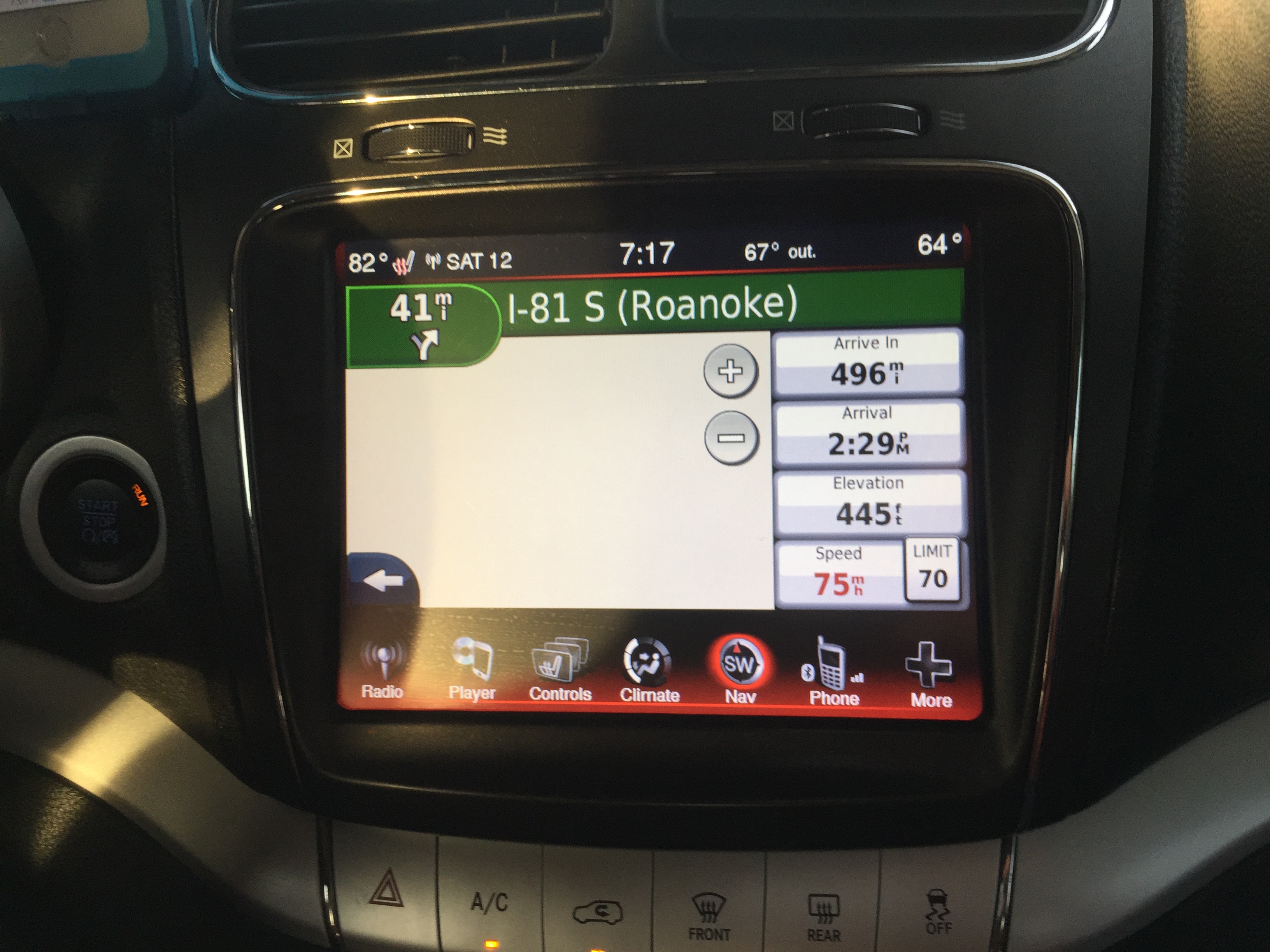

Mrgixxer6 Posted July 22, 2016 Report Share Posted July 22, 2016 Has a fix been found for the blank map issue? Â Today is the first time I've ever seen it. Â Of course as I'm driving to SC to visit my brother. Â The info screen still shows turn alerts and it still shows exits on the main screen as well. Â Gotta be a software hiccup. Â I haven't had the opportunity to stop and shut the car off yet. Â So unsure if that will fix it. Â I noticed it got stuck on calculating this AM before we left so I cancelled and then tried again. It got me started on my trip but sans maps lol! Quote Link to comment Share on other sites More sharing options...
Mrgixxer6 Posted July 22, 2016 Report Share Posted July 22, 2016 Reboot as noted earlier in this thread corrected it. Â Curious if anyone figured out this software issue? Â Supper odd. Â Now... I do have Maps from my Nuvi installed... Quote Link to comment Share on other sites More sharing options...
bramfrank Posted July 22, 2016 Report Share Posted July 22, 2016 Reinstall your maps. Quote Link to comment Share on other sites More sharing options...
dhh3 Posted July 23, 2016 Report Share Posted July 23, 2016 Use Waze on your phone! Quote Link to comment Share on other sites More sharing options...
