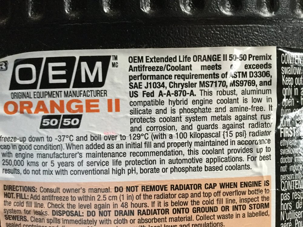

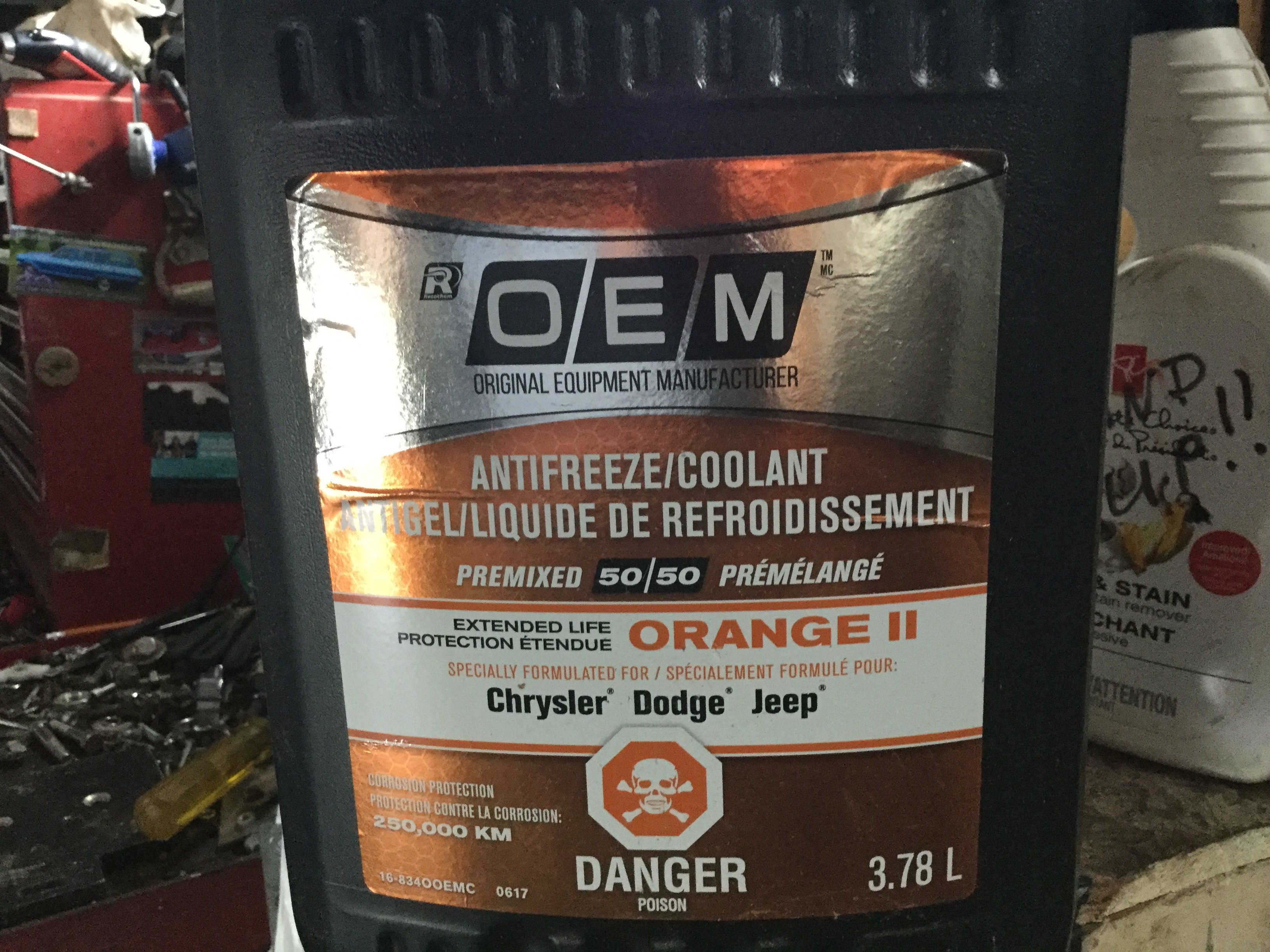

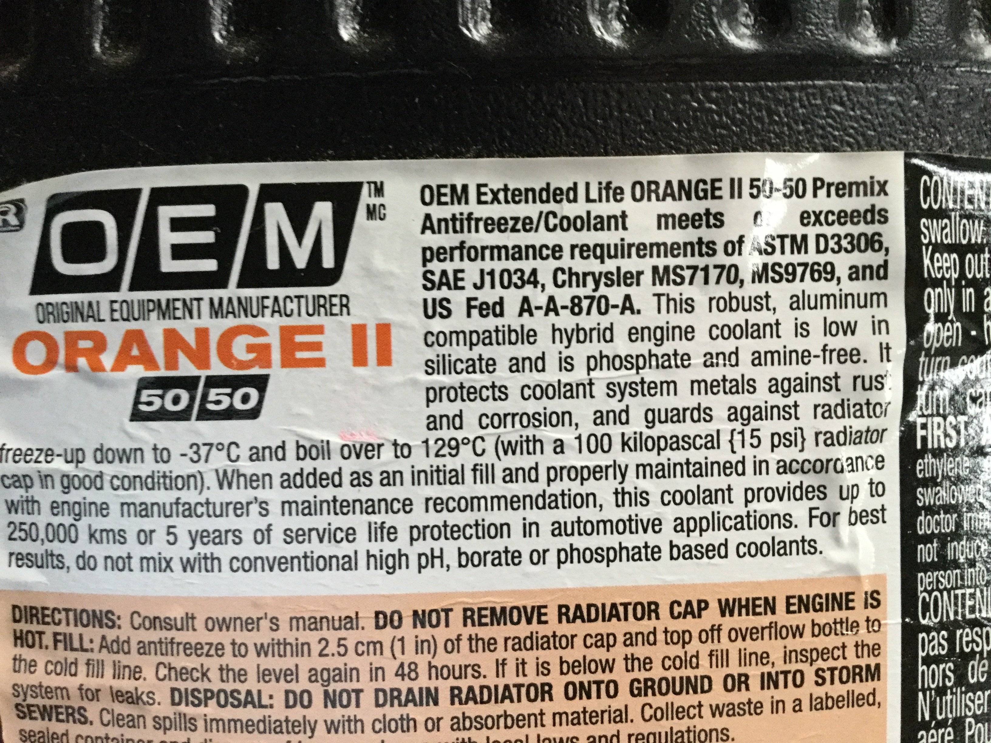

fcasontoo Posted September 5, 2020 Report Share Posted September 5, 2020 So, I had to replace radiator on my 2017 Crossroad and the fluid looked red, so I used Valvoline Xerox Asian motors 150,000 mile antifreeze, reddish/pinkish in color. Now I have a coolant leak, I believe at the water pump. Could wrong coolant cause this? Quote Link to comment Share on other sites More sharing options...
John/Horace Posted September 5, 2020 Report Share Posted September 5, 2020 (edited) The dude should abide with OEM spec fluids (sorry cant resist...I loved that movie). I doubt it, how long was fluid in for. What does fluid look like, it should look the same as when it was poured in. Valvoline May even make the Chrysler oem stuff. My pump had a drip at 100k miles with original fluid. The new fluids are usually an OAT formulation and there is a Chrysler spec number in the owners manual. Check the Japanese spec stuff to see if the Chysler spec is listed on container like on label below. Pics is what I have been using in my 2014 with orange stuff number 11 for two years now. Edited September 5, 2020 by John/Horace OhareFred 1 Quote Link to comment Share on other sites More sharing options...
