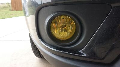

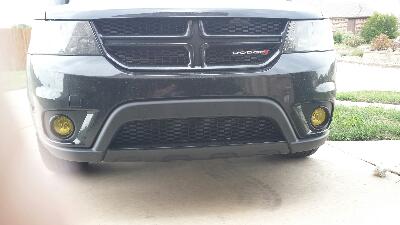

BlackTopJourney13 Posted July 20, 2013 Author Report Share Posted July 20, 2013 Fog lights tinted. Lighter than I wanted when on, but still happy! Lawdog1911 and dhh3 2 Quote Link to comment Share on other sites More sharing options...
Destination Posted July 22, 2013 Report Share Posted July 22, 2013 Did you get the the tint at Lamin-X? That's where I got mine, and mine are a little on the light side (when lit) too. dhh3 1 Quote Link to comment Share on other sites More sharing options...
BlackTopJourney13 Posted July 23, 2013 Author Report Share Posted July 23, 2013 Bought mine from eBay. 12x24 sheet. Very easy to install once you take off the fog molding. dhh3 1 Quote Link to comment Share on other sites More sharing options...
