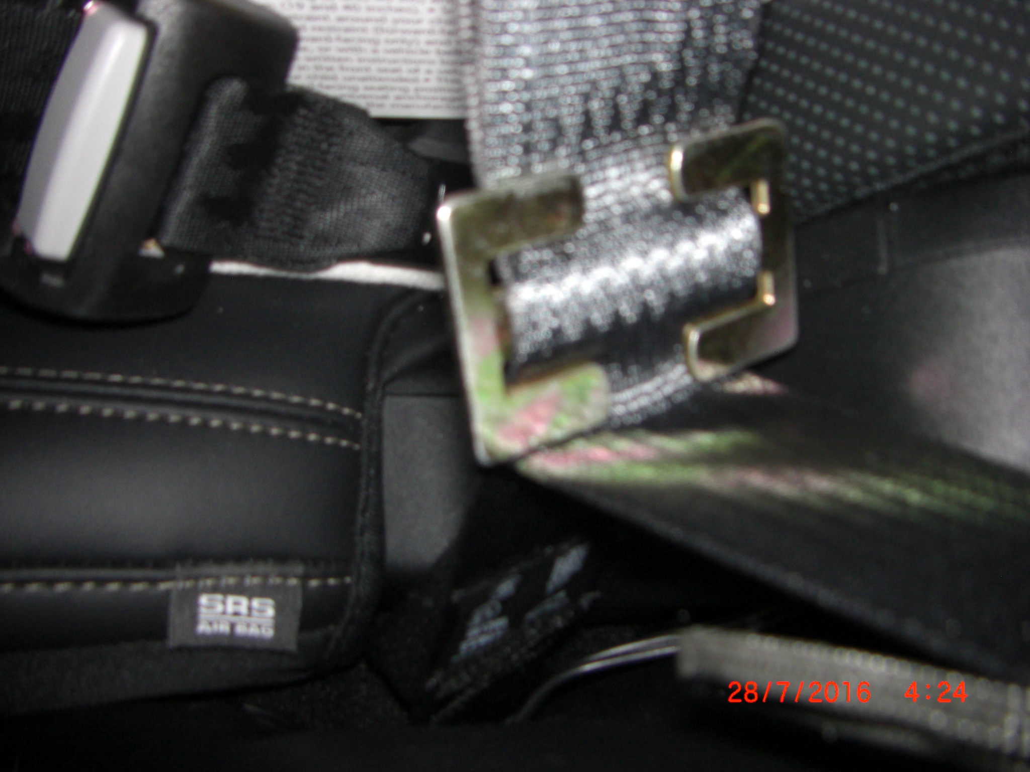

bigtsr Posted July 28, 2016 Report Share Posted July 28, 2016 (edited) There is a clip that comes with most child safety seats that clips the belt together this is what it looks like in my situation.This will stop it from unspooling keeping the belt tight. Edited July 28, 2016 by bigtsr add to explanation dhh3 1 Quote Link to comment Share on other sites More sharing options...
dhh3 Posted July 28, 2016 Report Share Posted July 28, 2016 I used the exact same clip for my daughter's car seat! She 22 now, so these clips have been around for a while. Quote Link to comment Share on other sites More sharing options...
