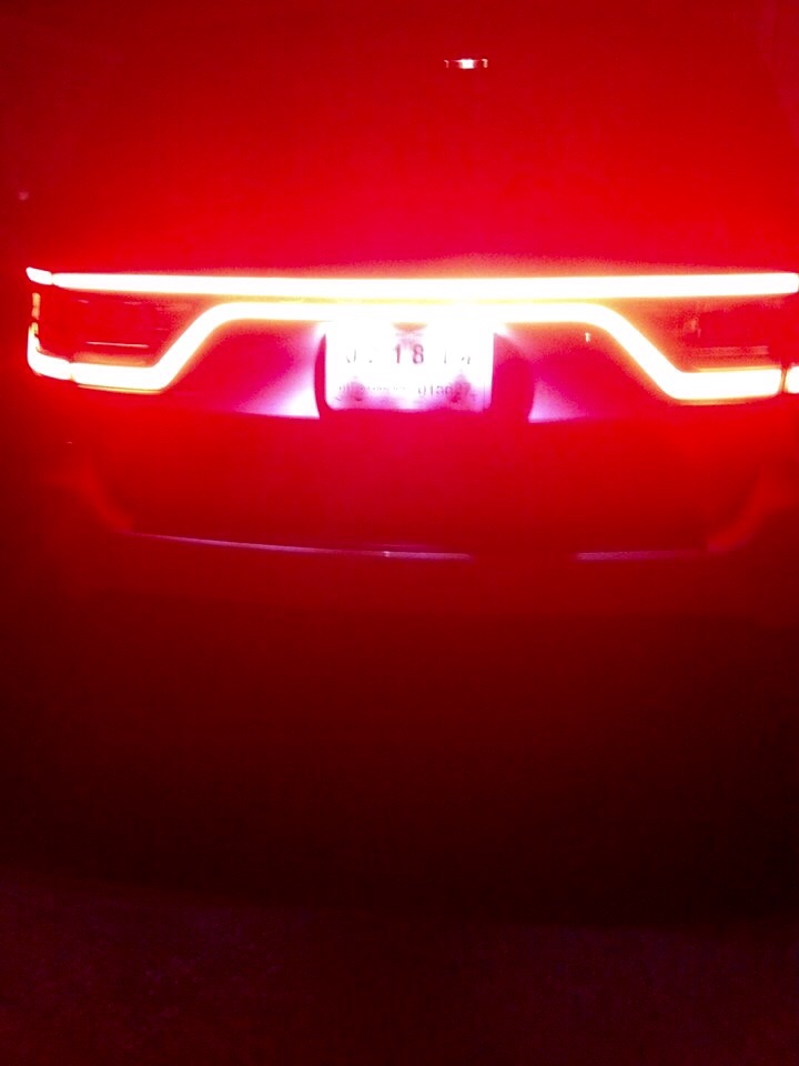

Journeyman425 Posted October 25, 2014 Report Share Posted October 25, 2014 Does your Durango have the Racetrack taillamps? Quote Link to comment Share on other sites More sharing options...
Libra1986 Posted October 25, 2014 Author Report Share Posted October 25, 2014 Yep, and they are SUPER bright. Quote Link to comment Share on other sites More sharing options...
Journeyman425 Posted October 25, 2014 Report Share Posted October 25, 2014 That is a badass setup for sure. I love it on the Durango, Charger and Dart. Best of luck with your Durango. I love it also, but my wife felt it was too big. I have to say that the Journey really is the perfect size for us. Quote Link to comment Share on other sites More sharing options...
