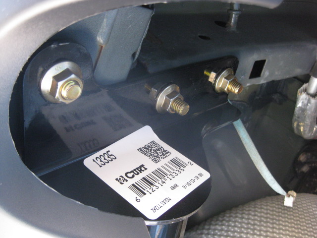

Install was easy, and pretty fast. My slowest time was getting the power wire through the rear suspension area. Did it by myself, my first hitch install also. Got the kit off of ebay.
From seller HitchMart1 for $198.44 shipped, and came with everything! Hope this helps people needing a hitch.

I installed my Curt 13335 Hitch the other day. Just like the OP said, pretty easy install. The only thing I didn't know was you have to remove the rear tow bar since it's in the way. Took me a minute to realize that. Just 2 bolts to take off the rear tow bar...and you don't need it now that the hitch has openings for a tow hook. Just a little FYI to watch out for.
Some tips for the wiring harness install since the instructions aren't that great. When routing the green T wire connectors, just pass them down through the drivers side taillight hole, then up over top of the rear bumper bar. You don't have to pull the bumper to do that, and it just rests nicely on top of the bumper bar. I originally went lower than that, and the wire ran short.
For the power wire to the battery, I routed mine through each wheel well, up and over the splash gaurds. Pretty easy to pull the splash gaurds down and route the wire over each wheel well. And just zip tie it along the ebrake cable. Then pull the front driver side splash gaurd back and connect it to the battery terminal there.
And finally, I'd recommend doing the wiring first, before the hitch install. I did it vice-versa and it was a lot harder to feed the wires with the hitch in the way. Hope this helps out future installs!
