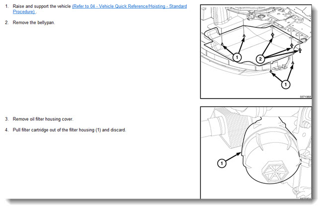

Kiteboarder666 Posted February 17, 2014 Report Share Posted February 17, 2014 Please help......have purchased oil filter and oil to change in my 2009 Dodge Journey 2.0 diesel but simply cannot locate the oil filter, have search engine and under pan area but cannot locate likely place....all forums indicate easy to change on 2012 models but 2009 is obviously different and struggling to find it...don't want to have costly visit to Dodge garage.....any ideas would be gratefully received. Many thanks. Quote Link to comment Share on other sites More sharing options...
jkeaton Posted February 17, 2014 Report Share Posted February 17, 2014 This has been asked before with no answer. No diesels here in the US. Hopefully someone from across the pond will chime in. Do you not have a owners manual? Can you call your locsall dealer and ask? I did find a pic of the oil filter housing here >> http://www.mopar.com/part/68103969AA?s=353095&i=2234199&b=dodge Might just have to pull the plastic engine cover off and start looking. It is an internal filter accessible by a cap somewhere. 2late4u 1 Quote Link to comment Share on other sites More sharing options...
Journey_SeXT Posted February 18, 2014 Report Share Posted February 18, 2014 Jkeaton is right, from looking at the picture of the actual oil filter it should be enclosed in a metal or plastic housing that has a bolt on the top just like the pic that Jkeaton provided. Pop off the the engine cover and look for it. On the 3.6 pentastar engines they provided access to the oil filter from the engine cover but in your case removal of the cover may be needed to gain access. Sorry if this is not much help as I could not find any better info on the net regarding the 2.0 diesel engine. Good Luck! Quote Link to comment Share on other sites More sharing options...
webslave Posted February 18, 2014 Report Share Posted February 18, 2014 I have the shop manual (CD) for the 2013 Journey. I can change the engine option and when I go to the 2.0L I4 diesel I get the attached image for where the oil filter is located. I don't imagine that the engine has changed that much and it may help you some. Apparently there is a belly pan that must be removed to access the canister that the oil filter fits in. Hope the attached helps; best I could do... Journey_SeXT 1 Quote Link to comment Share on other sites More sharing options...
