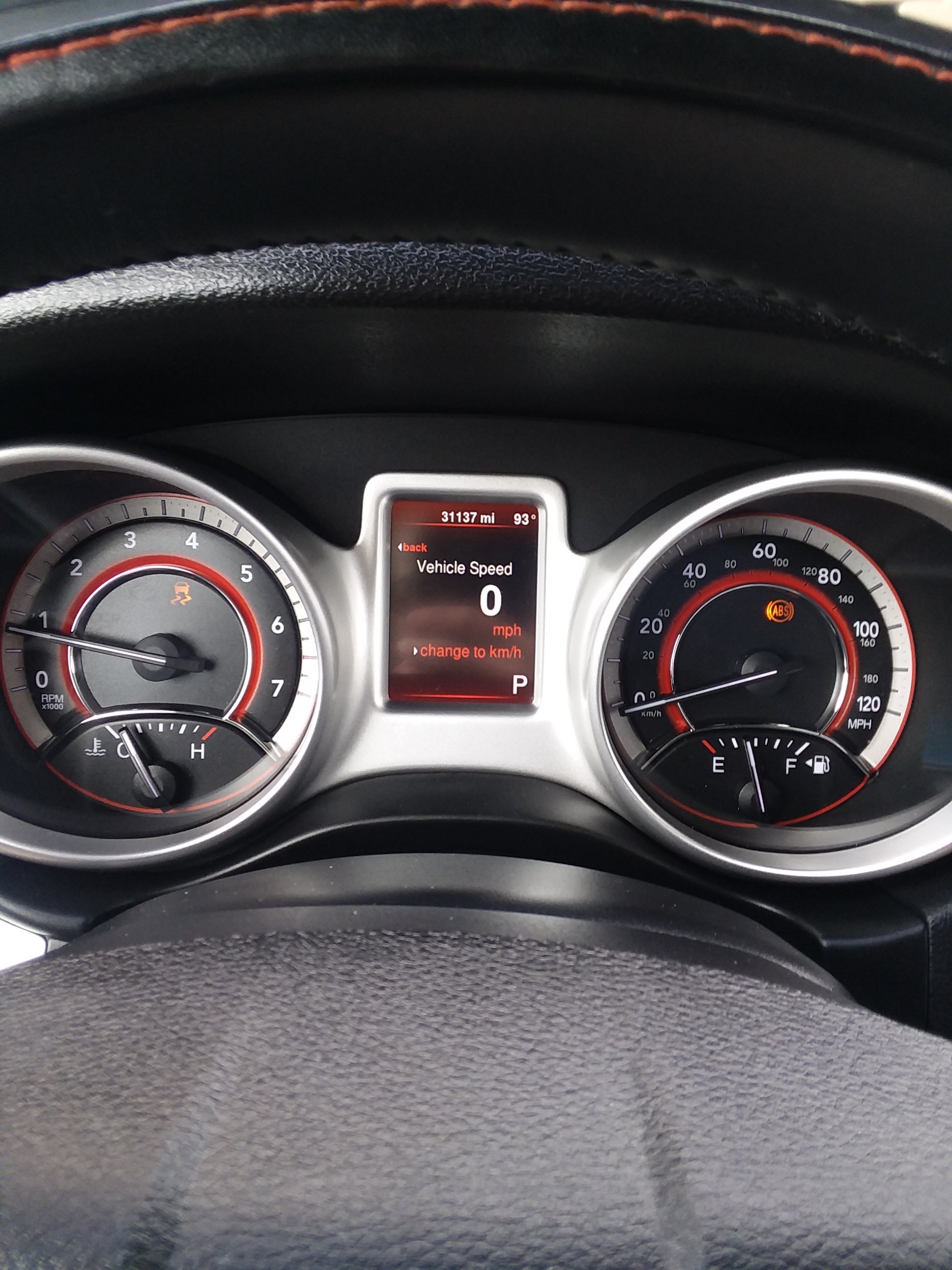

SoSassy84 Posted August 14, 2018 Report Share Posted August 14, 2018 Hi everyone I'm new. I live in NC and recently within the last week, had these lights come on, I'm happy they weren't on when I had my state inspection, I would've failed. I had 3 tires replaced and 1 where the tread is still great. The day these lights came on was the day I went to get my 3rd tire, I couldn't afford all 3 at once, but when I got paid about a week later I got the new one. We've had bad weather here and the day after 1 storm was when 2 lights came on. Then soon after the service AWD light came on. So traction control, AWD, ABS lights. They've been off only about twice. I have noticed recently that when I tried to lightly put my foot on the gas to get out of Wal-Mart's parking lot, it was having issues like I couldn't get moving quick enough, I was in the single digits before I pulled into an empty space and shut everything off and waited. I sat in my Journey for 5 minutes or so with 3 kids in the humidity because I didn't and still don't know wtheck is going on. It was fine after I turned it back on. The next day I had to go out again and I discovered the tire pressure was crazy high for 2 in the front(39psi) and the back 2 were either 38 or 37 psi. I made all 4 tires the same pressure and the lights came off. Now they are on. I'm worried because I have 3 kids and being a single mom I don't know how much it will cost to fix and how long it would take to fix it. Around here places take advantage of women and rip them off. So I'm on my own either way. I don't know if I should take it to a Dodge Dealership or to a chain store type business that deals in mechanics. I don't even know if they'd even just check it without me having to pay. I know someone who has a really nice code reader and no codes came up. Any advice would be appreciated. I live in a somewhat rural area and have to travel for my kid's appointments and football. I've never experienced this in my other Dodge and new tires, but this SXT hadn't had new tires and it was time. Any advice would be appreciated. It stormed so bad on a late drive home (my 1 son has DS and he was sick so we left urgent care at 1020pm our appt was for 830pm) that I was so worried because most of the roads were black top. Thank you in advance Quote Link to comment Share on other sites More sharing options...
larryl Posted August 14, 2018 Report Share Posted August 14, 2018 I believe the AWD system requires all 4 tires to be replaced at the same time because they all have to be the same spec wise or people have experienced the issues you are having 2late4u and jkeaton 1 1 Quote Link to comment Share on other sites More sharing options...
SoSassy84 Posted August 14, 2018 Report Share Posted August 14, 2018 1 minute ago, larryl said: I believe the AWD system requires all 4 tires to be replaced at the same time because they all have to be the same spec wise or people have experienced the issues you are having They are the same brand size etc. So what's the recommendation or advice that's not going to cut a chunk out of my already tight budget Quote Link to comment Share on other sites More sharing options...
larryl Posted August 14, 2018 Report Share Posted August 14, 2018 Sorry dont know what to tell you.... It takes money to own and operate a vehicle and they are a very complex and need diagnosis from people who know what they are doing. Maybe someone on here knows more...good luck jkeaton 1 Quote Link to comment Share on other sites More sharing options...
jkeaton Posted August 14, 2018 Report Share Posted August 14, 2018 11 hours ago, SoSassy84 said: They are the same brand size etc. So what's the recommendation or advice that's not going to cut a chunk out of my already tight budget If all 4 tires are now new and the same size, perhaps disconnecting the battery for a bit will reset everything. Otherwise, it takes a special scan tool to read the codes causing those lights which means a dealer trip unless you know someone who has such a tool. Good luck and be sure to post back what you find. 2late4u 1 Quote Link to comment Share on other sites More sharing options...
SylvainB Posted August 14, 2018 Report Share Posted August 14, 2018 It's probably just a sensor, traction control needs the ABS sensor to fonction properly so if one of your ABS sensor is bad that's why you have both lights ON. As all said, you need an OBD II reader to know which one failed or what is the cause for the lights to be on. With the codes it will be easier to know what to do, changing ABS sensor is pretty easy if that's your problem and the sensor itself is not expensive. But again you need to at least get someone to the read the codes. I wouldn't go the the dealer just for reading codes but that's just me .... I bought on eBay and OBD II reader that plug's in a computer (replicate one of the old version) for 5 bucks, it's not genuine but it's work as intended on the dodge Journey mine is a 2011. Be prepared cause DJ may cost you some money to own. It's a nice car but you need to do some yourself. Quote Link to comment Share on other sites More sharing options...
SoSassy84 Posted August 15, 2018 Report Share Posted August 15, 2018 11 hours ago, larryl said: Sorry dont know what to tell you.... It takes money to own and operate a vehicle and they are a very complex and need diagnosis from people who know what they are doing. Maybe someone on here knows more...good luck I never said I didn't have the money. I don't have the money to get ripped off, large army base, it happens. Quote Link to comment Share on other sites More sharing options...
Journeyman425 Posted August 15, 2018 Report Share Posted August 15, 2018 You’ve likely got a faulty wheel speed sensor. You’ll need to have the vehicle scanned for codes to determine which one. Each of the four wheels has a sensor. If any one sensor fails, the ABS and traction control systems will be disabled as well as the AWD. Quote Link to comment Share on other sites More sharing options...
