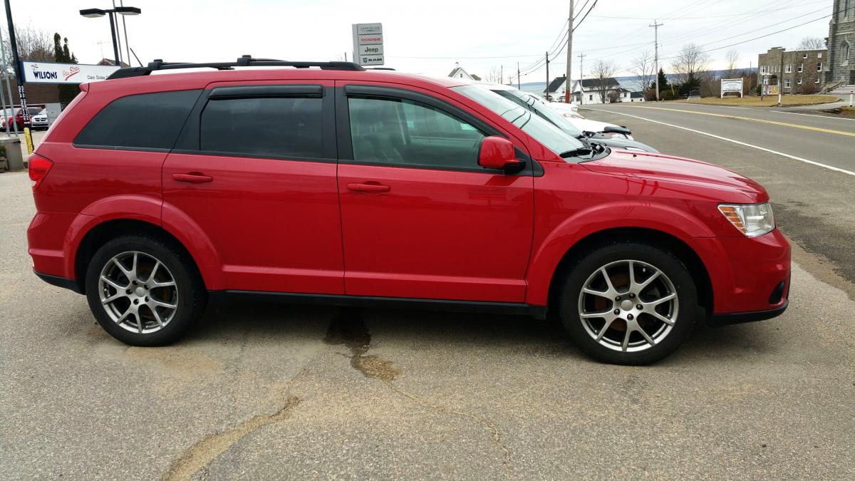

Unclemarker Posted April 4, 2016 Report Share Posted April 4, 2016 hello everyone ,its been awhile since i have been on here ,and in the last post i had made i said my first and last Dodge Journey,well since then i have bought a 2012 R/T and love it . Also would like to apoligize for being so quick at the time to put down my other journey and anyone i may have offended at the time . dhh3 and jkeaton 2 Quote Link to comment Share on other sites More sharing options...
jkeaton Posted April 5, 2016 Report Share Posted April 5, 2016 hello everyone ,its been awhile since i have been on here ,and in the last post i had made i said my first and last Dodge Journey,well since then i have bought a 2012 R/T and love it . Also would like to apoligize for being so quick at the time to put down my other journey and anyone i may have offended at the time . Pics??? Les see it!! dhh3 1 Quote Link to comment Share on other sites More sharing options...
Steve_T Posted April 5, 2016 Report Share Posted April 5, 2016 Welcome back, I hope this time around you have better luck. We bought a '15 R/T before Christmas and love it! jkeaton and dhh3 2 Quote Link to comment Share on other sites More sharing options...
Unclemarker Posted April 5, 2016 Report Share Posted April 5, 2016 thank you very much jkeaton and dhh3 2 Quote Link to comment Share on other sites More sharing options...
Unclemarker Posted April 5, 2016 Report Share Posted April 5, 2016 better photos to come and still learning how to use the site ,and thanks for the welcome back jkeaton and dhh3 2 Quote Link to comment Share on other sites More sharing options...
