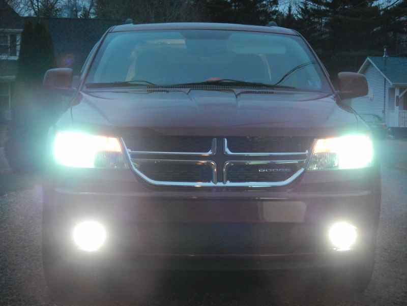

journeyfamily Posted July 18, 2014 Report Share Posted July 18, 2014 i have putco led fog light bulbs with HID head light bulbs mine look great no problems Link to comment Share on other sites More sharing options...

journeyfamily Posted July 26, 2014 Report Share Posted July 26, 2014 Did you put them in yourself? I ordered a set of H16, as I did some reading on some other forums and this seems to be the "correct" replacement for the Dodge fog bulbs, not 5202 (as seems to be quoted by every company I can find). I didn't get a chance to try these yet, but I will be doing it this week if the weather cooperates. A lot of the websites for bulbs quote many of these as interchangeable, but they're not. The keyed slots are in different spots, and they are VERY slightly different widths (probably in the 1/100s of an inch range) and you will break the housing or the bulb if you force them in. If I find the exact match for this, I will post info on it. This is taking a long time, but I will eventually figure it out. :P I need fog lighting (in AMBER) badly here, as we get fog in late summer so dense you can't see 50 feet in front of you. The stock lights aren't "fog" lights, they're driving lights, and worthless in dense fog. P.S. - The HIDs I installed in my 9006 spots are a VAST improvement over the stock lighting. Who would have thought that blacking out the headlight casings (Blacktop edition) would cause a reduction in visible light? :P Oh, wait.... yes i put these in myself, only took about 10 minutes, Link to comment Share on other sites More sharing options...
