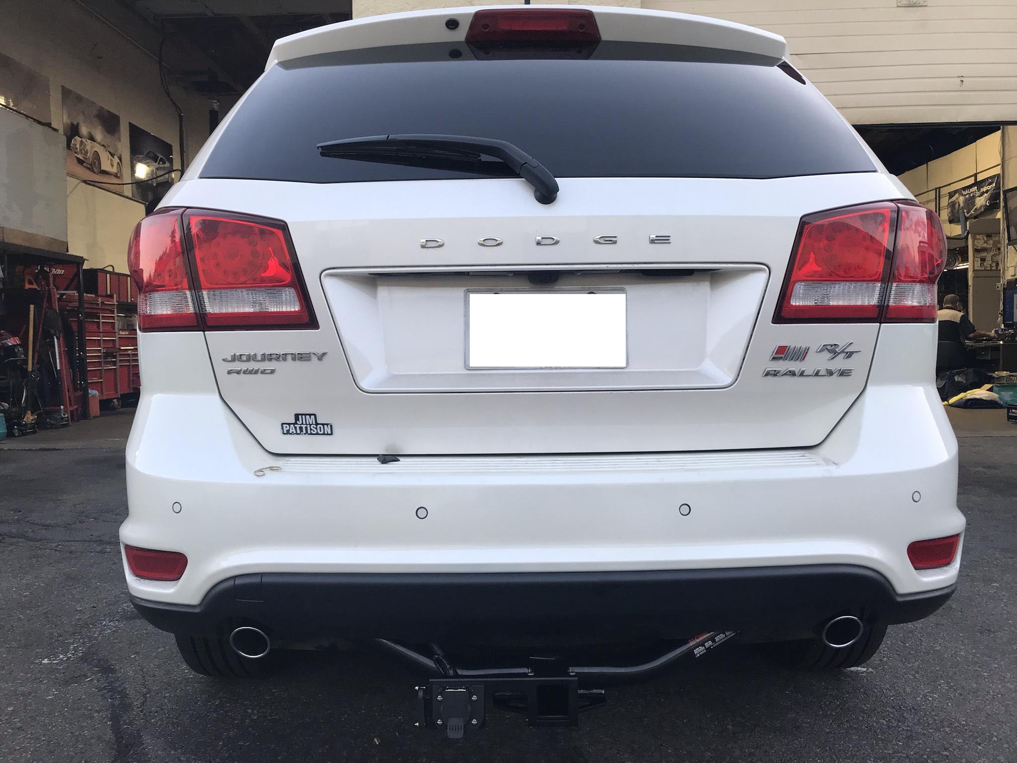

journey13 Posted August 8, 2021 Report Share Posted August 8, 2021 (edited) I just installed a Curtis Hitch on my 2013 Dodge Journey R/T Rallye Stage 3. I purchased the following kits: CURT Manufacturing 56330 Vehicle-Side Custom 4-Pin Trailer Wiring Harness for Select Dodge Journey CURT Manufacturing 55774 Dual-Output Vehicle-Side Trailer Wiring Harness Connectors for Select USCAR Vehicles, 7-Pin Trailer Wiring, 4-Pin Trailer CURT Manufacturing 56229 USCAR Replacement Vehicle End Wiring with 24" Wires (7 Way Vehicle end with 24 in Bonded Wire) CURT Manufacturing 13201 Class 3 Trailer Hitch, 2-Inch Receiver for Select Dodge Journey CURT Manufacturing 58000 Easy Mount Electrical Bracket for 2" Receiver Tube CURT Manufacturing 23518 Black Trailer Hitch Lock 5/8-Inch Pin Diameter Fits 2-Inch Receiver CURT Manufacturing 45036 Class III 2" Loaded Ball Mount with 2" Ball Attached a picture of what it looks like finished after 10 hrs of work. One of the reasons for the length of time is because for some stupid reason, CURT wire's do not follow standard colors. The colors from 56229 to 55774 to 56330 are different color schemes. I was nearly pulling my hair out for 4 hrs hahaha. Thankfully, I have documented it all so I made sense out of it. But man, frustrating! Edited August 8, 2021 by journey13 Typo 2late4u 1 Quote Link to comment Share on other sites More sharing options...
