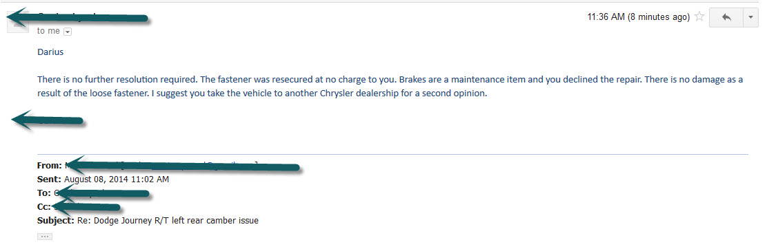

Marius Posted August 8, 2014 Author Report Share Posted August 8, 2014 (edited) Here's the Service Manager's reply today to my request for a resolution on this Edited August 8, 2014 by Marius Quote Link to comment Share on other sites More sharing options...
Marius Posted August 8, 2014 Author Report Share Posted August 8, 2014 Is there any online CS from Dodge around here, or do I have to try to contact corporate? Funny thing is I was close to getting a fully loaded 3500 RAM. Guess who's buying a Ford soon. Quote Link to comment Share on other sites More sharing options...
Lobitz68 Posted August 8, 2014 Report Share Posted August 8, 2014 DodgeCACares is the Canadian rep on the board... Don't know that I would ever buy a car because of a bad experience at a dealer, but that fastener being gone is certainly not good. Good luck in getting a resolution; if you are really serious about it, local media always seems to cause enough attention to get things done. Quote Link to comment Share on other sites More sharing options...
jkeaton Posted August 8, 2014 Report Share Posted August 8, 2014 Good luck with the Ford.... Quote Link to comment Share on other sites More sharing options...
Official Dodge Support DodgeCACares Posted August 12, 2014 Official Dodge Support Report Share Posted August 12, 2014 Is there any online CS from Dodge around here, or do I have to try to contact corporate? Funny thing is I was close to getting a fully loaded 3500 RAM. Guess who's buying a Ford soon. DodgeCACares is the Canadian rep on the board... Don't know that I would ever buy a car because of a bad experience at a dealer, but that fastener being gone is certainly not good. Good luck in getting a resolution; if you are really serious about it, local media always seems to cause enough attention to get things done. Marius, Sorry to learn of the experience with your dealers and your DJ. How many kilometers do you have on the vehicle now and what schedule have you been following for tire rotation? Quote Link to comment Share on other sites More sharing options...
