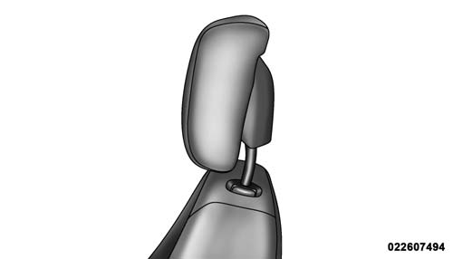

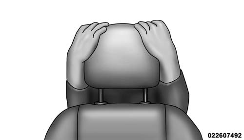

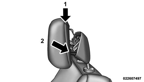

jkeaton Posted July 28, 2017 Report Share Posted July 28, 2017 (edited) 8 hours ago, Ramit said: This happened in my Grand Caravan, however we were not in a collision. I think it deployed due to my kids horsing around. Anyway, my user's manual does not have these instructions.Could you provide me details instructions on how to reset, please? So you need the instructions for a Caravan or a Journey? For the Journey, it is indeed in the manual how to reset: Resetting Active Head Restraints (AHR) If the Active Head Restraints are triggered in a collision, you must reset the head restraint on the driver’s and front passenger seat. You can recognize when the Active Head Restraint has been triggered by the fact that they have moved forward. 1. Grasp the deployed AHR from the rear seat Hand Positioning Points On AHR 2. Position the hands on the top of the deployed AHR at a comfortable position. 3. Pull down then rearward towards the rear of the vehicle then down to engage the locking mechanism. 1 — Downward Movement 2 — Rearward Movement 3 — Final Downward Movement To Engage Locking Mechanism 4. The AHR front soft foam and trim half should lock into the back decorative plastic half. AHR In Reset Position NOTE: • If you have difficulties or problems resetting the Active Head Restraints, see an authorized dealer. • For safety reasons, have the Active Head Restraints checked by a qualified specialist at an authorized dealer Edited July 28, 2017 by jkeaton 2late4u 1 Quote Link to comment Share on other sites More sharing options...
