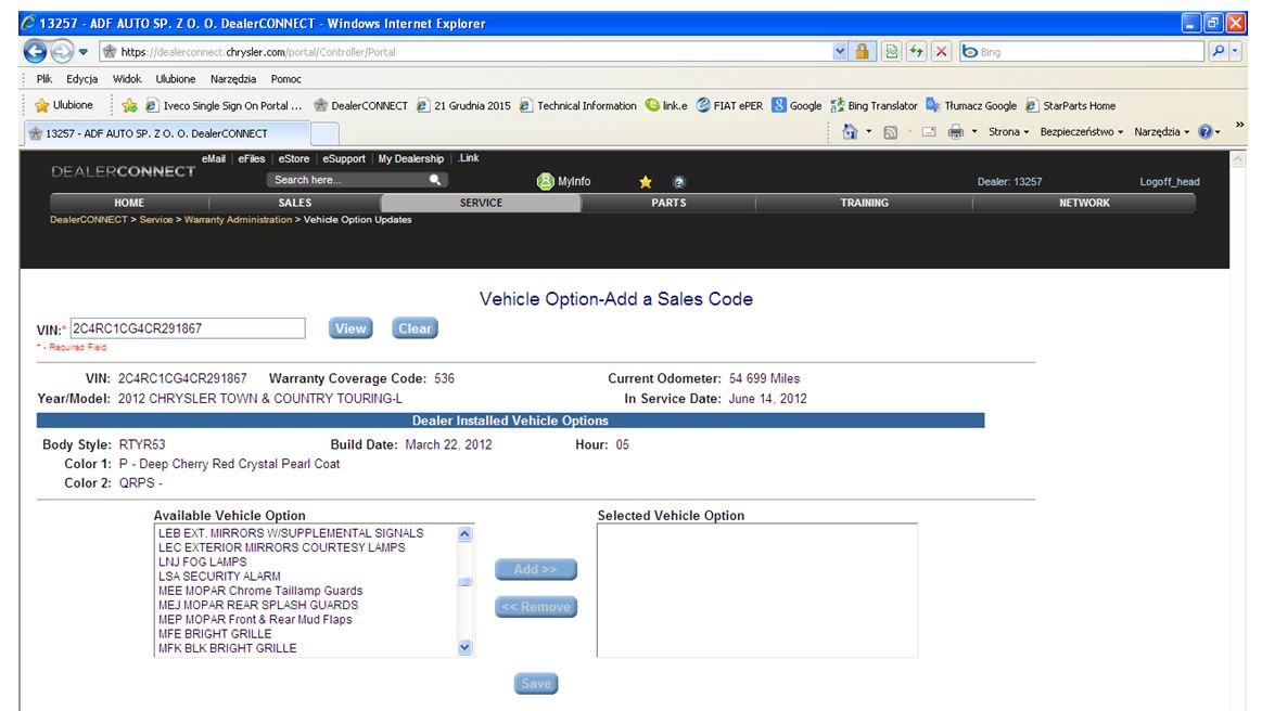

Blaza Posted February 19, 2017 Report Share Posted February 19, 2017 Hello. Is there anybody who can check/add LMK code to my VIN? I've tried to my local dealer with no success. He checked in Vehicle Option Updates, but code doesn't exist there. Maybe should looking somewhere else? My VIN is: 2C4RC1CG4CR291867 Quote Link to comment Share on other sites More sharing options...
jkeaton Posted February 19, 2017 Report Share Posted February 19, 2017 On 2/19/2017 at 3:02 PM, Blaza said: Hello. Is there anybody who can check/add LMK code to my VIN? I've tried to my local dealer with no success. He checked in Vehicle Option Updates, but code doesn't exist there. Maybe should looking somewhere else? My VIN is: 2C4RC1CG4CR291867 Expand The sales code is still not available. Quote Link to comment Share on other sites More sharing options...
Blaza Posted February 19, 2017 Report Share Posted February 19, 2017 On 2/19/2017 at 3:19 PM, jkeaton said: The sales code is still not available. Expand Thank You. Not happy about it Quote Link to comment Share on other sites More sharing options...
Journeyman425 Posted February 19, 2017 Author Report Share Posted February 19, 2017 On 2/19/2017 at 3:02 PM, Blaza said: Hello. Is there anybody who can check/add LMK code to my VIN? I've tried to my local dealer with no success. He checked in Vehicle Option Updates, but code doesn't exist there. Maybe should looking somewhere else? My VIN is: 2C4RC1CG4CR291867 Expand That is the correct area. The code is no longer there for dealers to add. Just to be sure, I double checked just now on the DealerConnect page. At one point FCA re-instated the LMK code for us to add, and then removed it again. I keep checking periodically to see if it comes back. If it does, I will update you all. Quote Link to comment Share on other sites More sharing options...
Blaza Posted February 19, 2017 Report Share Posted February 19, 2017 On 2/19/2017 at 6:09 PM, Journeyman425 said: That is the correct area. The code is no longer there for dealers to add. Just to be sure, I double checked just now on the DealerConnect page. At one point FCA re-instated the LMK code for us to add, and then removed it again. I keep checking periodically to see if it comes back. If it does, I will update you all. Expand Thank you. Can't wait. Quote Link to comment Share on other sites More sharing options...
jkeaton Posted February 20, 2017 Report Share Posted February 20, 2017 (edited) If DRL's are not mandated where you live, then you are out of luck for now. You may be unhappy about it, yes. But maybe you should have checked before purchase if this is a "must have" feature for you. Edited February 20, 2017 by jkeaton Quote Link to comment Share on other sites More sharing options...
Blaza Posted February 20, 2017 Report Share Posted February 20, 2017 On 2/20/2017 at 2:03 PM, jkeaton said: If DRL's are not mandated where you live, then you are out of luck for now. You may be unhappy about it, yes. But maybe you should have checked before purchase if this is a "must have" feature for you. Expand I'm not complaining, because as you said, I know what I bought. This is wish have. Currently I'm very close to achieve the goal using Chinese cheep ELM 327 device and write settings directly to BCM. Will let you know about progress. jkeaton 1 Quote Link to comment Share on other sites More sharing options...

Loghousegal Posted April 26, 2017 Report Share Posted April 26, 2017 So if my Dodge Journey is a 2014, I'll need to order a factory component in order for my daytime running lights to work????? Quote Link to comment Share on other sites More sharing options...
jkeaton Posted April 27, 2017 Report Share Posted April 27, 2017 No. Read all the posts in this thread. It needs to be activated by the dealer. And currently the activation code is not available. Quote Link to comment Share on other sites More sharing options...

wildfire Posted May 22, 2017 Report Share Posted May 22, 2017 (edited) Eh. Long story short. I showed all three codes as was noted in the link above. These were tested, applied but not able to be set successfully. It is possible that the issue is related to not having the headlamp "Auto" capability.. Reference, https://www.dodge.com/download/pdf/ug/2016-Journey-UG-1st.pdf?myyear_ug=22&myvehicle_ug=2 Illustration #1 So for now I'll stand down. Perhaps I'll try a different dealer or wait to see what others have experienced when there is more time. Edited May 22, 2017 by wildfire Quote Link to comment Share on other sites More sharing options...
Journeyman425 Posted May 22, 2017 Author Report Share Posted May 22, 2017 On 5/22/2017 at 4:55 PM, wildfire said: Eh. Long story short. I showed all three codes as was noted in the link above. These were tested, applied but not able to be set successfully. It is possible that the issue is related to not having the headlamp "Auto" capability.. Reference, https://www.dodge.com/download/pdf/ug/2016-Journey-UG-1st.pdf?myyear_ug=22&myvehicle_ug=2 Illustration #1 So for now I'll stand down. Perhaps I'll try a different dealer or wait to see what others have experienced when there is more time. Expand LMK is the only sales code that applies to the Journey (known internally as JC in Chryslerspeak) It has been unavailable to me to add for well over a year now, probably closer to two years. If you provide the last eight digits of your VIN to me I will be happy to double check. The Auto headlamp option has no bearing on DRL capability. Auto headlamps require a sales code all their own. Quote Link to comment Share on other sites More sharing options...
Journeyman425 Posted May 22, 2017 Author Report Share Posted May 22, 2017 Re-checked just now - no code. At this point I'm not expecting it to come back. It seems to me that FCA has made LMK an option that must be added to the sales order prior to the vehicle being built. Quote Link to comment Share on other sites More sharing options...
Baumrb Posted May 23, 2017 Report Share Posted May 23, 2017 I was able to have mine turned on last Friday - I'm not exactly sure how they did it but I did inform them off adding the LMK code; and now they work! So there is a way still 2late4u 1 Quote Link to comment Share on other sites More sharing options...
km-04 Posted August 29, 2017 Report Share Posted August 29, 2017 I have the option to turn them on via the settings on the radio screen, but they do not come on. Guess that means I need the now non obtainable dealer code? Quote Link to comment Share on other sites More sharing options...
jkeaton Posted August 29, 2017 Report Share Posted August 29, 2017 On 8/29/2017 at 11:42 AM, km-04 said: I have the option to turn them on via the settings on the radio screen, but they do not come on. Guess that means I need the now non obtainable dealer code? Expand That is correct. Quote Link to comment Share on other sites More sharing options...
