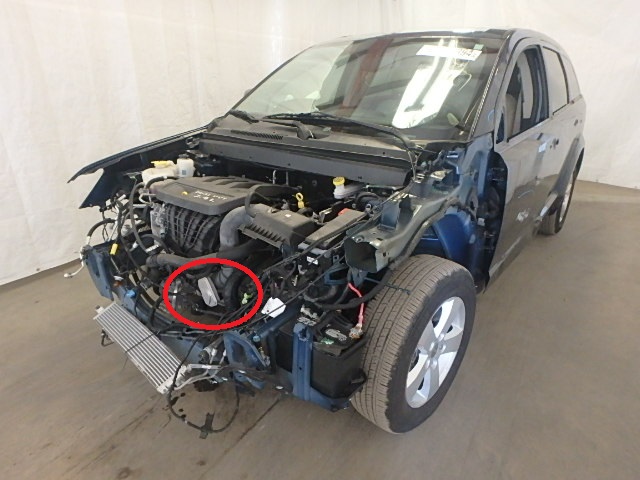

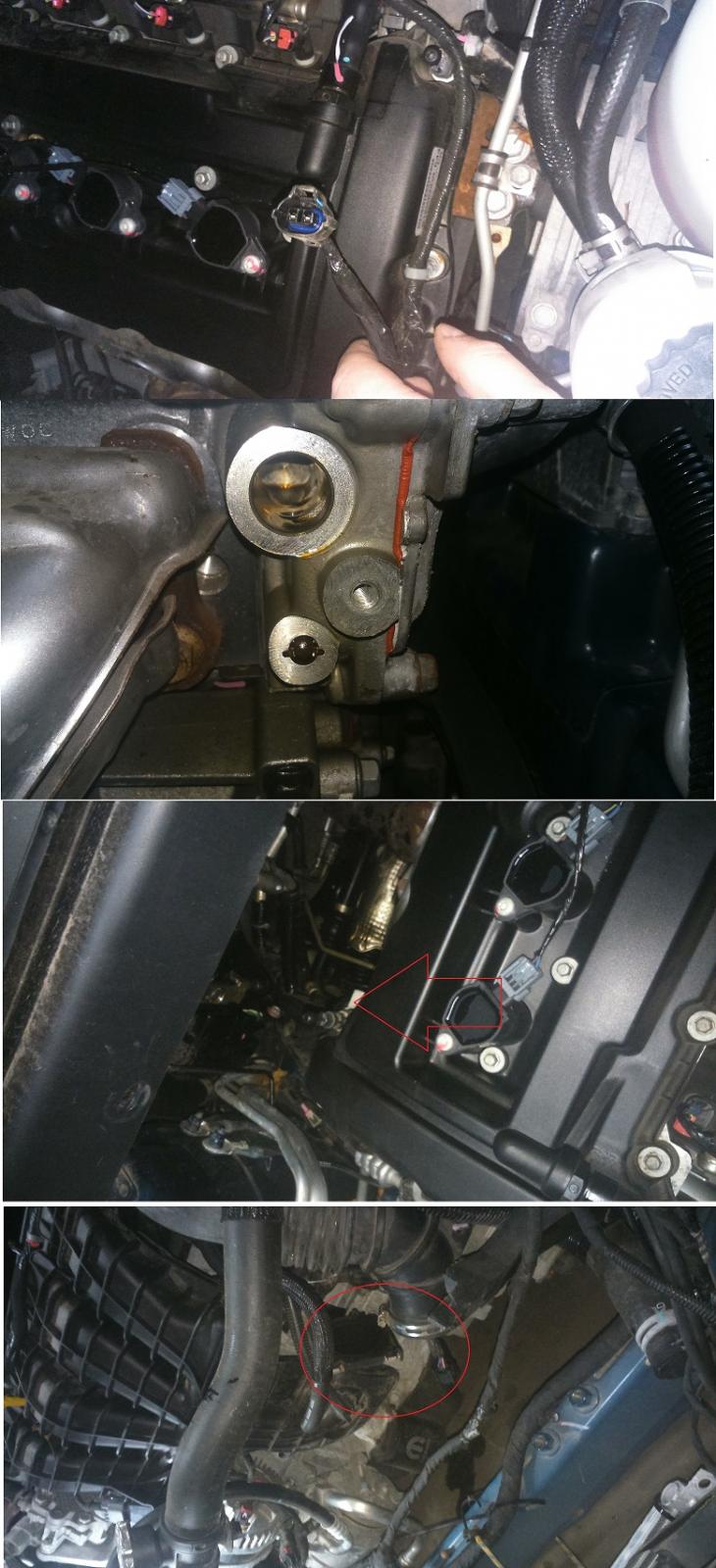

thomasch Posted November 6, 2014 Report Share Posted November 6, 2014 Hello everyone In 08/25/13 i bought trough a broker at Copart the 2013 Dodge Journey 2.4 Unfortunately after delivery i turned out that the throttle and some sensor has been stolen. I do not know what a sensor is missing, ther is only a empty space and the plug. The pictures showed where there was a sensor and a plug that was connected to it. Please help my in choosing the right sensor and throttle. Quote Link to comment Share on other sites More sharing options...

thomasch Posted November 6, 2014 Author Report Share Posted November 6, 2014 The car does not start without the throttle. During start-up oli is pumped through the hole and flooding the engine. Condition of the car at the auction was that the engine starts and the car is runing. At the pictures from the auction can see that the throttle is in the car. With the selection of the trottle I can handle, it's no problem to found on eBay: Manufacturer Part Number: 4591735ACAC But I do not know what is the missing sensor? Quote Link to comment Share on other sites More sharing options...

thomasch Posted November 6, 2014 Author Report Share Posted November 6, 2014 (edited) I know that I need whole throttle and the missing sensor. Any name of the missing sensor showen in the example pictured engine 2.4 Edited November 6, 2014 by thomasch Quote Link to comment Share on other sites More sharing options...

thomasch Posted November 7, 2014 Author Report Share Posted November 7, 2014 I have it! This is a VVT exhaust shaft sensor. New in Dodge dealer cost 125PLN about 40$ Unfortunately I have to pick up personally from the dealer which is 60 miles from my home. Quote Link to comment Share on other sites More sharing options...
