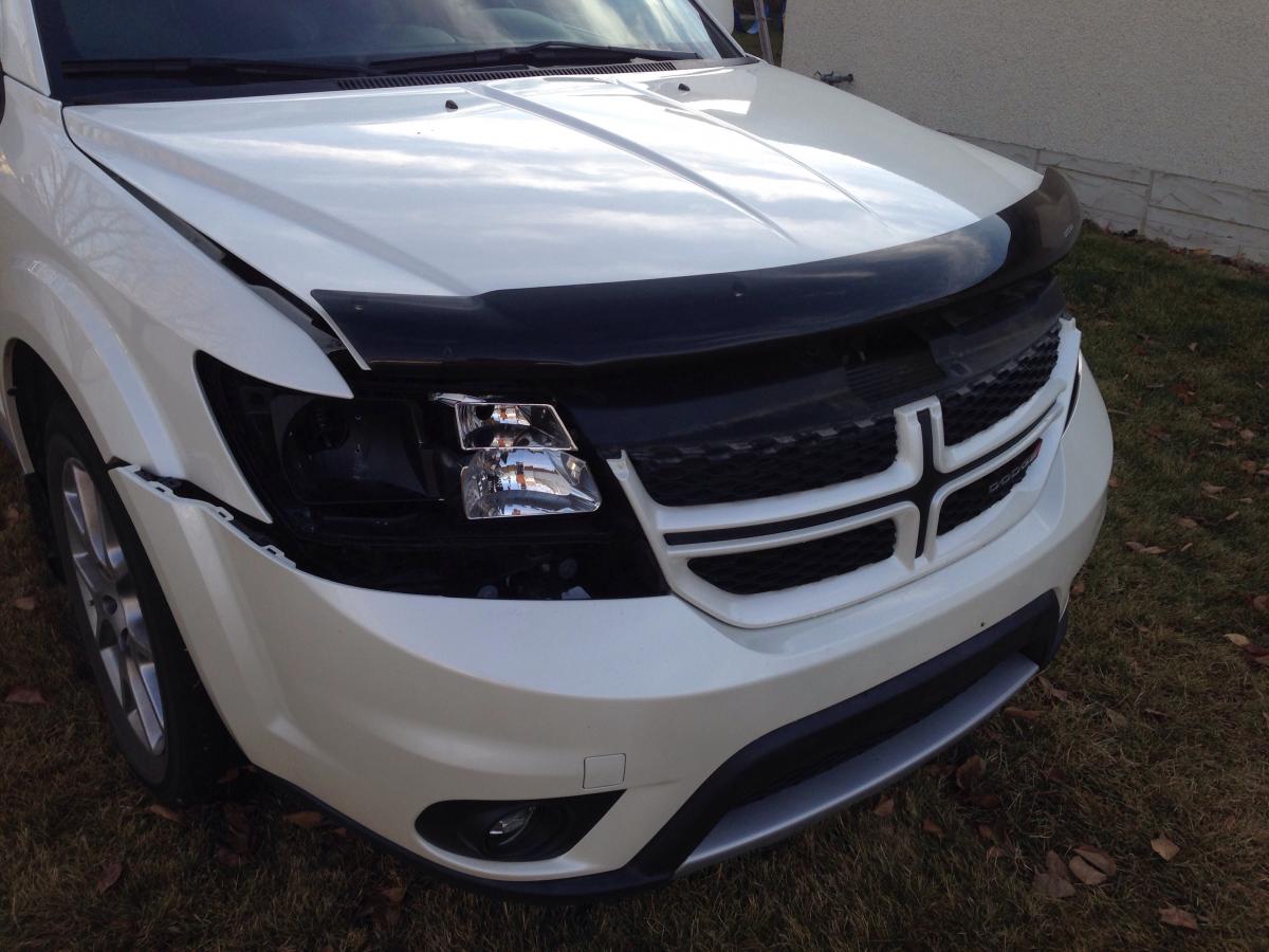

Powerz69 Posted November 19, 2014 Report Share Posted November 19, 2014 (edited) Search....... http://www.dodgejourneyforum.com/topic/1935-headlight-assembly/?hl=%2Bheadlight+%2Bremoval#entry13026 Really? I couldn't get the headlights out without removing the 3 screws on the end of the bumper. I removed the 5 push in clips at each wheel wells, 4-5 clips on top of the grill, 3 screws on each side of the bumper and 3 bolts from each headlight.I would like to know how much the grill and bumper has to bend to get the headlight out? Out of fear I never overly bent mine. Picture with my bumper lowered. Edited November 19, 2014 by Powerz69 Quote Link to comment Share on other sites More sharing options...
Lobitz68 Posted November 19, 2014 Report Share Posted November 19, 2014 Really? I couldn't get the headlights out without removing the 3 screws on the end of the bumper. I removed the 5 push in clips at each wheel wells, 4-5 clips on top of the grill, 3 screws on each side of the bumper and 3 bolts from each headlight. I would like to know how much the grill and bumper has to bend to get the headlight out? Out of fear I never overly bent mine. Picture with my bumper lowered. I had to do this as well... No way in hell they are coming out otherwise. Quote Link to comment Share on other sites More sharing options...
