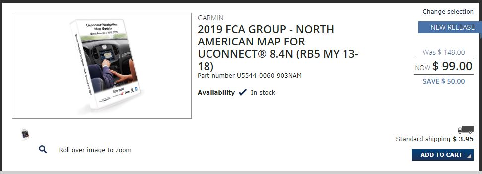

Jerry in TX Posted August 29, 2019 Report Share Posted August 29, 2019 I hope this may be useful to others. I recently received in the mail an offer from FCA (or Dodge) to update my maps for $99USD. From the fine print on the back this applies to Dodge Journeys 2013-18 and is valid thru Sep 30, 2019 (see attached PDF). The link to apply for the update is fcagroup.navigation.com/update. You enter your unit ID and I guess it will tell you if you are eligible and then start the payment and download process. IMO, if you haven't had a problem with your unit, and you don't navigate with it much (you use a separate GPS or phone) I don't know why you would bother. But if you have had problems, or maybe your unit has had a map failure and you have just lived with it, this might be valuable to you. If for no other reason someday you will go to sell your Journey and your prospective buyer will want that feature. For me, I live around Houston, which is a BFC ('big city" in the superlative) and I use my navigation a lot. One of the things that really sold me on the Journey was the fact that the Journey/Dodge systems use the Garmin interface and I have been using Garmin GPSs for many, many years. Very simple and easy to use. Well worth it to me to have updated maps. YMMV. Hope this helps someone... Map Update from Dodge 2019-08-28.pdf Quote Link to comment Share on other sites More sharing options...
Jerry in TX Posted August 29, 2019 Report Share Posted August 29, 2019 The order is for a USB stick that they mail to you. Shipping is $3.95USD. Here are a couple of screenshots (attached). Coverage is for North America (incl Canada and Mexico). BTW, I used this when I drove our Journey across Mexico for 6 weeks to Puerto Vallarta and back with wife and dog. Great trip, but the point here is the nav system was awesome! A real lifesaver! Map Update from Dodge - Website screenshot1 2019-08-28.pdf Map Update from Dodge - Website screenshot2 2019-08-28.pdf Quote Link to comment Share on other sites More sharing options...
