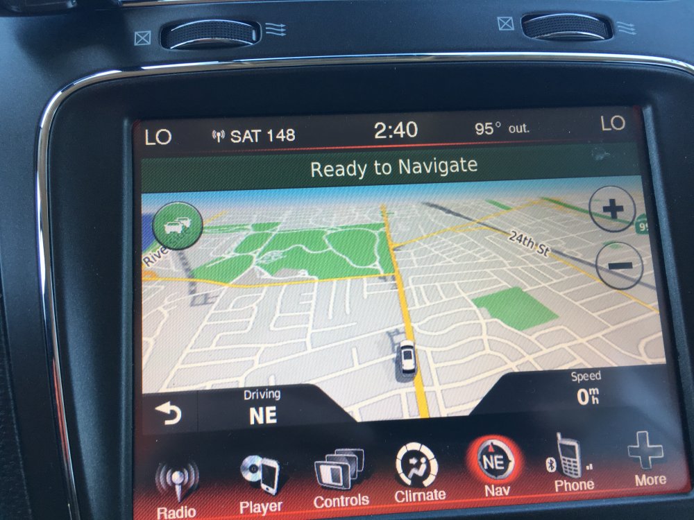

draydon Posted September 5, 2019 Report Share Posted September 5, 2019 Hi all, I got my the USB and great news it worked for me. Maps are updated and no more "Can't Unlock Maps" error. Cost me $164 shipped to my door the next day. This is with the current $50 savings which is applied at check out. Note savings is only applied until 30 Sept 19. Again all I had showing was the "Can't Unlock Maps" box and no access to the Navigation features. All other things worked normally IE radio etc..... Took around an hour to follow the instructions and install. I hope this helps anyone else with this issue where it out of warranty. Summer Solstice 1 Quote Link to comment Share on other sites More sharing options...

martyman.geo Posted November 24, 2019 Report Share Posted November 24, 2019 Hey all, I went back to the website two weeks ago and the maps are available again. Ordered and installed in my DJ and now works like a champ (again). Summer Solstice 1 Quote Link to comment Share on other sites More sharing options...
Jack Koval Posted January 14, 2020 Report Share Posted January 14, 2020 Another success story here. Downloaded the updates from Chrysler for the RB5 and ordered the latest Maps which arrived 2 days later. Uploaded the software in the following order, Radio, nav unit and then maps. Works perfect! Thanks to all who figured this out. Jack jkeaton and martyman.geo 2 Quote Link to comment Share on other sites More sharing options...
