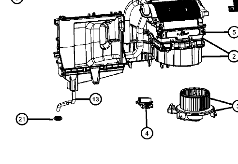

bigtsr Posted December 1, 2014 Report Share Posted December 1, 2014 I have never checked mine but here is a pic from parts book and it is item 13 appears to exit by gas pedal. Quote Link to comment Share on other sites More sharing options...
Lobitz68 Posted December 1, 2014 Report Share Posted December 1, 2014 You'll likely need to access it from the engine bay side of the fire wall... poke it with a wire or a pipe cleaner. That should free it up. Quote Link to comment Share on other sites More sharing options...
