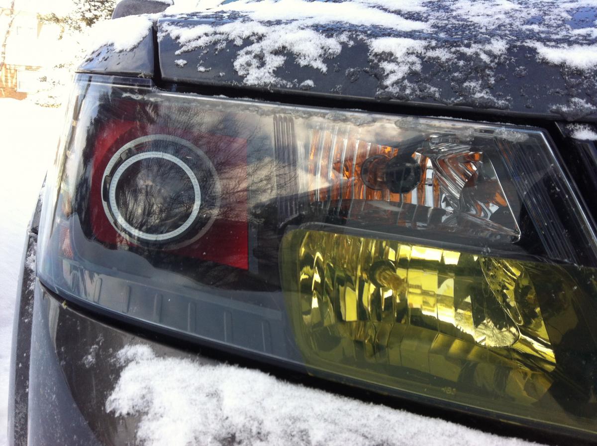

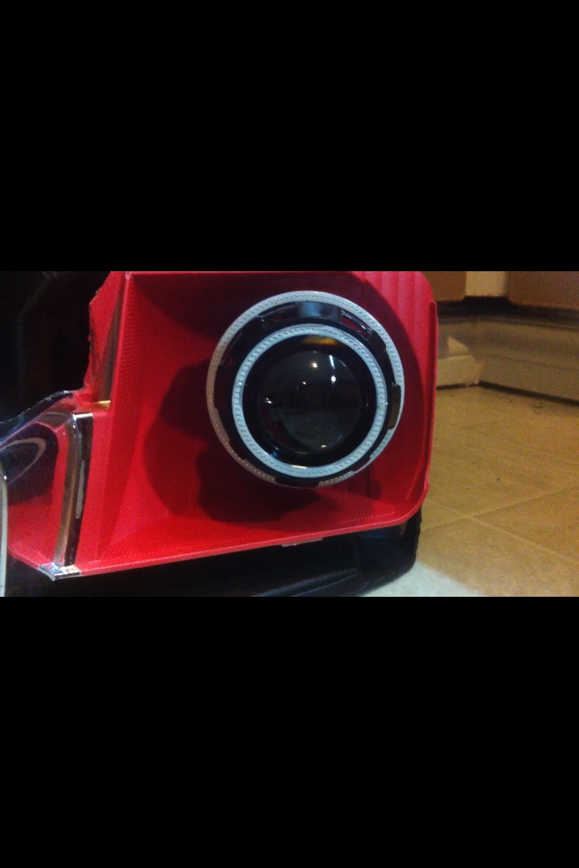

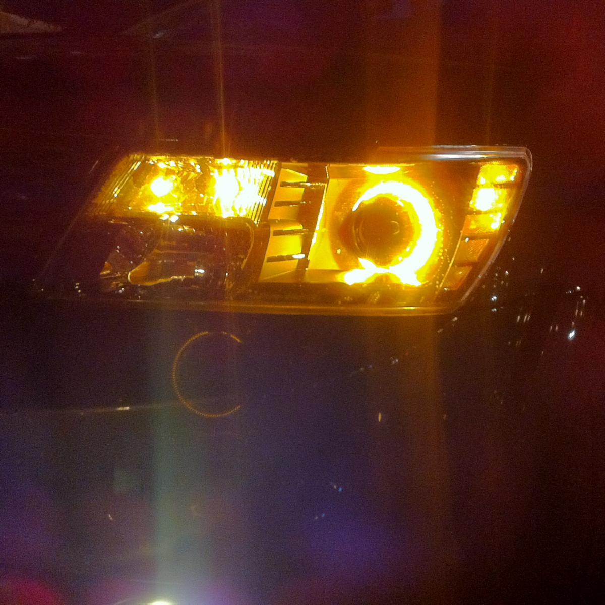

Cody Chornobey Powley Posted March 22, 2015 Report Share Posted March 22, 2015 Do a projector upgrade from the retrofit source. You'll smack yourself and say what was I thinking. I've done it. Look at my pics Quote Link to comment Share on other sites More sharing options...

Cody Chornobey Powley Posted March 26, 2015 Report Share Posted March 26, 2015 Mini h1 fits nice! Md2s needs trimming on the bezels Lobitz68 and 11journeybama 2 Quote Link to comment Share on other sites More sharing options...
Lobitz68 Posted March 26, 2015 Report Share Posted March 26, 2015 On 3/26/2015 at 12:01 AM, Cody Chornobey Powley said: Mini h1 fits nice! Md2s needs trimming on the bezels Yeah, I have the MH1's and they were about as simple as you could imagine to put in... I will say that the permaseal headlights that Dodge uses are a bit of a pain (especially if you are new to retrofittting) and that it would be wise to get a set of TYC replacement lights... Best price I found, by a long shot, was on Rockauto.com. Quote Link to comment Share on other sites More sharing options...
