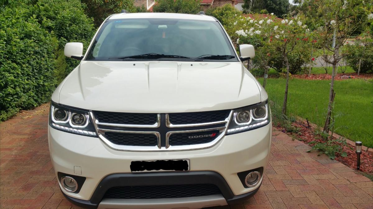

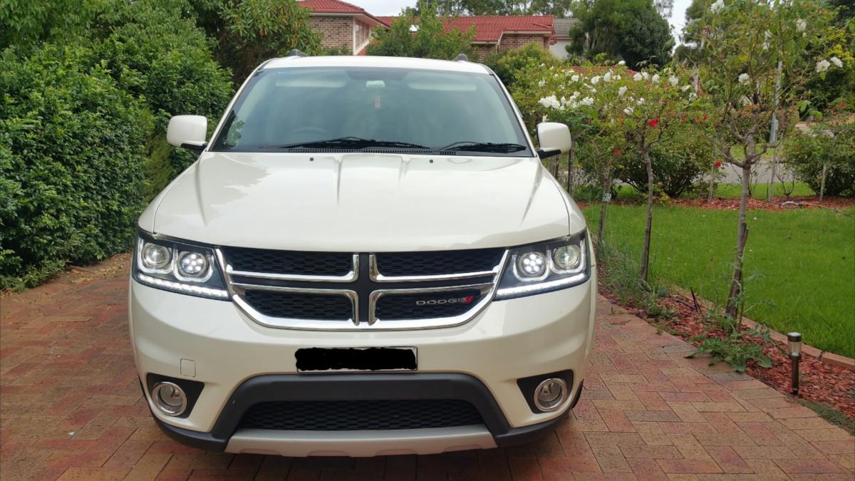

evil129 Posted February 20, 2015 Report Share Posted February 20, 2015 (edited) Hi all, After few months of stage by stage mod, I finally completed my plan, here is my Journey 2015 edition: LED headlight (2nd gen aftermarket headlights) DRL (installed by auto-electrian, need tiny mod to fuse box) Together with LED turn signal light HID low beam & 6 mini led high beam Detail look into the headlights Shark fin antenna (not a dummy) Back (little chrome touch, and a V6 badge) Finally the light effect at night http://i.imgur.com/wGb0JKI.jpg Edited February 20, 2015 by evil129 Lawdog1911, dhh3, Mark R. Monaco and 3 others 6 Quote Link to comment Share on other sites More sharing options...

evil129 Posted February 20, 2015 Author Report Share Posted February 20, 2015 Hi all, here is the explaination how the lights works, When your car at ignition/ACC (run mode), both the yellow and green part lights up white; When u trigger turn signal, green part blinks in orange and yellow part remain solid white; When in low beam, blue part lights up with the rest; In high beam, red part light up with all the rest. This the back of the light, each light come with a 32w canbus for the HID, it fits all the OEM connecter except there is one extra DRL led positive This is where the DRL goes into fuse box,please install with a professional auto electrician. →Lobitz68, I believe the low is projecter, and high is LEDs, I am not sure what cutoff do you mean, can u please explain? →dhh3, I added the V6 logo myself shop from eBay, The shark fin will not affect reception cos it has copper parts n wired into the vehicle's antenna port. I borrow the pic from the seller.. Lawdog1911 and dhh3 2 Quote Link to comment Share on other sites More sharing options...

evil129 Posted February 25, 2015 Author Report Share Posted February 25, 2015 Hi all, I shop this set of headlights from Amazon, shipped from china factory to me. Quote Link to comment Share on other sites More sharing options...
evil129 Posted February 25, 2015 Author Report Share Posted February 25, 2015 the cutoff note, my car is right hand driving, accorring to manufacturer, for RHD, the cut off is higher on left and low on right; LHD will be the opposite way, the product by default is for Left hand drive, mine one has been modified to fit RHD. note 2, the garage door I shot is uneven on both side, the left half is deeper than the right. Quote Link to comment Share on other sites More sharing options...
B4ZINGA Posted February 25, 2015 Report Share Posted February 25, 2015 Thanks for the picture, it does look like a decent cutoff for an aftermarket projector. It's difficult to tell if there are hotspot, though, given how close you are to the house. Are you able to take a picture of it from a further distance from the wall? With the car 15+ feet (25 preferred, but I don't know how long your driveway is) back from the wall. That will tell us if there is any hotspotting or glare above the cutoff. Almost looked like there was, but I think that was the light on the house lol. Found it on Amazon... wow, $720 shipped and before buying bulbs/HID kit. But that makes two models to choose from if you don't do your own retrofit. The other set is $660 shipped and resembles the OEM design, with DRL along the bottom. Quote Link to comment Share on other sites More sharing options...
