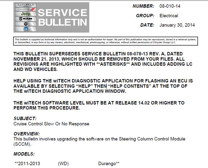

patelajit Posted February 26, 2015 Author Report Share Posted February 26, 2015 patelajit, There is a TSB that may apply to your issue. TSB# 08-010-14. If your software level is below 14.02, you may need to upgrade that first. If this TSB does indeed pertain to your cruise control issue, the repair involves upgrading the software for the Steering Column Control Module. I have a screenshot of the TSB attached below. DodgeCares, Thank you for the information. For me when I turn on cruise there is no light and nothing happens. Could it be fuse? I checked but there is not fuse listed for cruise control. Also, about this TSB is it only possible thru dealership (they will charge 2 arms and 2 legs)? Thank you! dhh3 1 Quote Link to comment Share on other sites More sharing options...
Lobitz68 Posted February 26, 2015 Report Share Posted February 26, 2015 DodgeCares, Thank you for the information. For me when I turn on cruise there is no light and nothing happens. Could it be fuse? I checked but there is not fuse listed for cruise control. Also, about this TSB is it only possible thru dealership (they will charge 2 arms and 2 legs)? Thank you! Only possible through the dealership. It is just a software update, so the labor fee should be no more than 1 hour.. dhh3 1 Quote Link to comment Share on other sites More sharing options...

redtomatoman Posted August 1, 2017 Report Share Posted August 1, 2017 Steering Column Control Module (SCCM). That's very likely your problem. Good luck. Peace. OhareFred and jkeaton 2 Quote Link to comment Share on other sites More sharing options...
patelajit Posted August 1, 2017 Author Report Share Posted August 1, 2017 My cruise control (2011 journey) was not working. There was no indicator light. Also, my traction control indicator light was on. It turned out to be a faulty clock spring. After replacing the clock spring, cruise control is working and traction control warning indicator light also went away. 2late4u 1 Quote Link to comment Share on other sites More sharing options...
