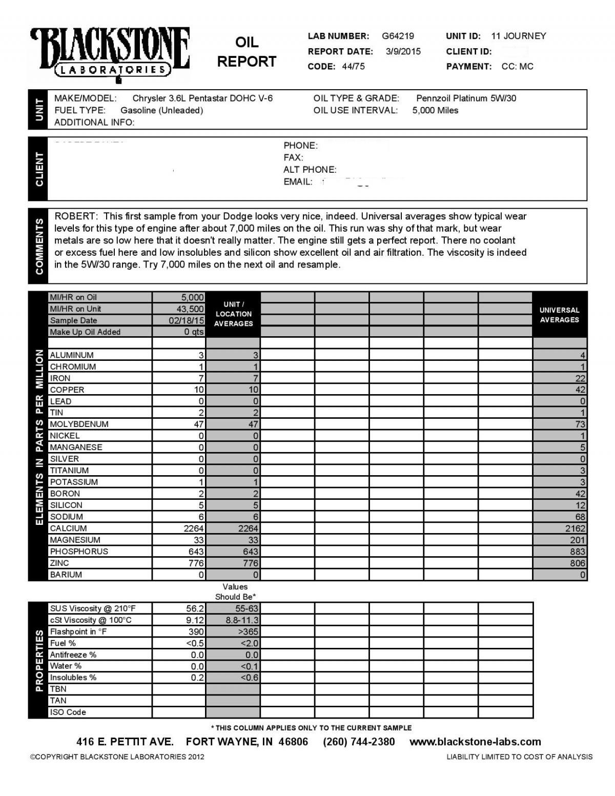

Journey_SeXT Posted March 18, 2015 Report Share Posted March 18, 2015 Hi All, Thought I would share my oil analysis sheet after a 5,000 mile / 8,000 km OCI with Pennzoil Platinum 5w-30 and a Bosch Premium Filter after a very cold winter. I was surprised at the results and hope this will eliminate any fears for anyone who would like to go a little longer with their OCI's. I think I will go 10,000 km's / 6,000 mile on the next change with Valvoline Synpower 5w30. Dodge really did a good job with these Pentastar engines. onecrazyfoo4u 1 Quote Link to comment Share on other sites More sharing options...

Journey_SeXT Posted March 18, 2015 Author Report Share Posted March 18, 2015 I was at 43,500 miles (70,000 km's). The cost is $25.00 and if you want you can get the TBN for $10.00 extra. I did it just to know for sure that everything is okay and if I'm okay to extend my intervals which I can. You can check it out here: http://www.blackstone-labs.com/ onecrazyfoo4u 1 Quote Link to comment Share on other sites More sharing options...
onecrazyfoo4u Posted March 18, 2015 Report Share Posted March 18, 2015 On 3/18/2015 at 10:32 PM, Journey_SeXT said: I was at 43,500 miles (70,000 km's). The cost is $25.00 and if you want you can get the TBN for $10.00 extra. I did it just to know for sure that everything is okay and if I'm okay to extend my intervals which I can. You can check it out here: http://www.blackstone-labs.com/ Very cool. I may do it and report back what mine is showing for comparison! What is TBN? Looking again, it's weird that Calcium is the only thing that reported above national average. I wonder why that is? Quote Link to comment Share on other sites More sharing options...
Journey_SeXT Posted March 18, 2015 Author Report Share Posted March 18, 2015 (edited) TBN gives you the amount of life left in your oil....this is excellent for those trying to max out their oil change interval which I would never do but for those who do the 10,000 mile plus oil change they might want to see if the oil can handle it or not. Edited March 18, 2015 by Journey_SeXT Quote Link to comment Share on other sites More sharing options...
Journey_SeXT Posted March 18, 2015 Author Report Share Posted March 18, 2015 On 3/18/2015 at 10:40 PM, onecrazyfoo4u said: Looking again, it's weird that Calcium is the only thing that reported above national average. I wonder why that is? Calcium is a detergent in the engine oil. Molekule "BITOG" oil guru probably explains it best here: Calcium is mainly a detergent and magnesium at one time was used in dispersants but its use has declined since magnesium leaves ash deposits. Newer ashless dispersants are now used to disperse sludge molecules and soot. Calcium compounds are "multifunctional" additives since they not only lift deposits, but also serves as a friction modifier and tbn booster. onecrazyfoo4u 1 Quote Link to comment Share on other sites More sharing options...
