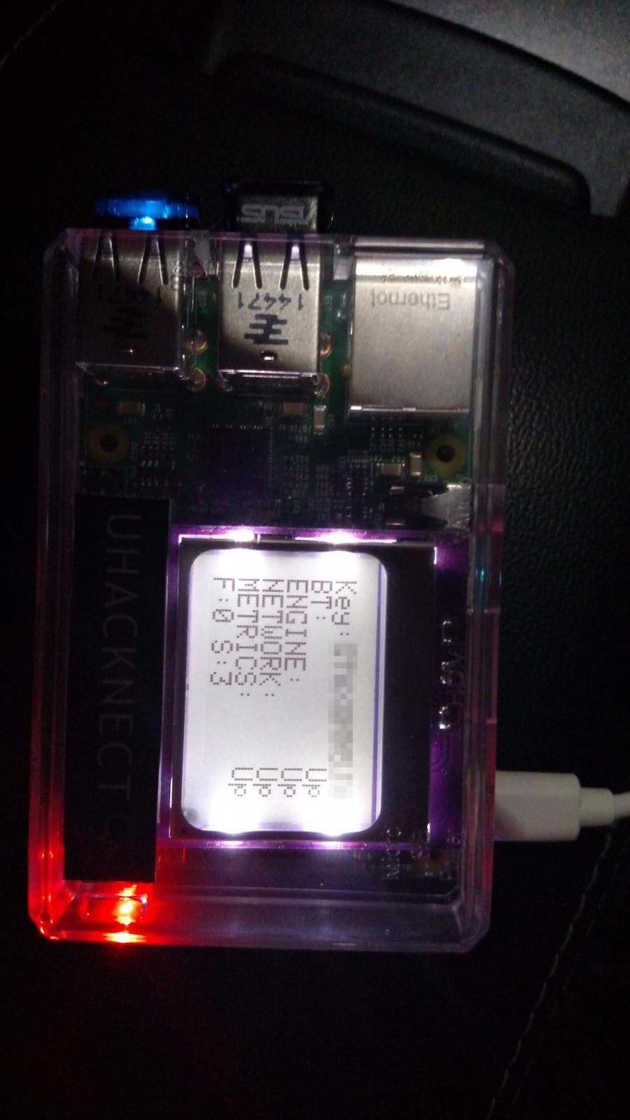

HawtDogFlvrWtr Posted June 12, 2015 Author Report Share Posted June 12, 2015 (edited) Sneak preview of uHacknect Mark II. Smaller, Faster, Cleaner. Still have an intermittent AWD light coming on when my app attempts to do something naughty. AWD is actually on, it's just triggering the light and a ding.. As of now, it only happens every 20+ trips and turns off on vehicle shutdown. Edited June 12, 2015 by HawtDogFlvrWtr Quote Link to comment Share on other sites More sharing options...
HawtDogFlvrWtr Posted June 13, 2015 Author Report Share Posted June 13, 2015 (edited) Another teaser.. i've had a lot of time to work out a few kinks tonight.. I've also completely changed the LCD Display functions so they are called from the main script, instead of some backwoods c++. It now provides realtime information that's pertinent, rather than OS related crap. From top to bottom, here are what each line mean: 1. This is the key that you use when adding a vehicle to the site. I've blurred it because if you know my key, you can add my vehicle to the site and control it. I will probably make this only appear if the vehicle hasn't been added to the site already.. after which, it will just disappear and be filled with other data. Kind of like enabling a device for use on netflix, they provide a key that you enter on the site, and the device is registered. 2. This tells you if the device has a connection to the OBD2 dongle (OBDLink LX) on the vehicle. This says down, because i'm testing it at my desk and not near my vehicle. Normally it would say Up. 3. This is the status of the engine.. if it's started or stopped. I know it doesn't seem important to display that as you'll be in the vehicle at the time, but for testing purposes, it's important for me to know that the device can actually tell if the engine is online or not. 4. This tells me if the device is able to call back to www.uhacknect.com successfully. The other day I implemented server side code to display icons on the dashboard that say if the device has talked back to us within the last 30 seconds. I will also display icons for the engine being on, and if the OBD2 dongle is connected. All this will be viewable on the dashboard page. 5. This tells me if the last metrics push to www.uhacknect.com happened successfully or if it failed. 6. This is a count of failed and successful metrics pushes to uhacknect.com. I want to know how many times we tried to push metrics but failed and how many times it succeeded. If you can think of other useful information to display on this screen (remember, it's going to be in the center console) please let me know. Edited June 13, 2015 by HawtDogFlvrWtr Quote Link to comment Share on other sites More sharing options...
