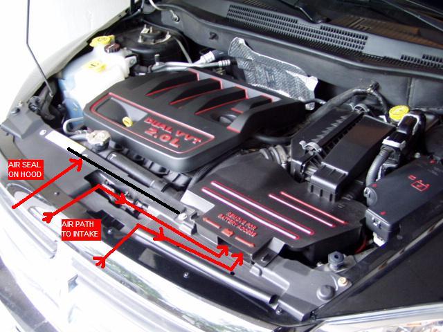

bigtsr Posted April 11, 2015 Report Share Posted April 11, 2015 I had a Dodge Caliber for 5 yrs and the air path was similar , here's a pic of it I did for a forum. Quote Link to comment Share on other sites More sharing options...

bigtsr Posted July 4, 2015 Report Share Posted July 4, 2015 It's the same principle in the pic I posted in #8 , it guides high pressure lead edge "cold " air to the air intake. Quote Link to comment Share on other sites More sharing options...
