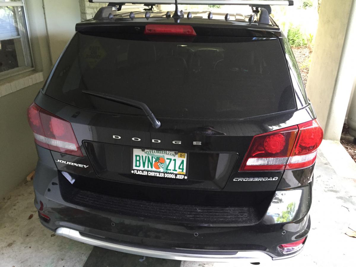

Woah322 Posted September 9, 2015 Report Share Posted September 9, 2015 Why plasti dip on the crossroad if already factory tinted. Wish the blacktop models would come with the tinted tail lights, I mean if the headlights are why not the taillight as well. dhh3 1 Quote Link to comment Share on other sites More sharing options...
carritt11 Posted September 9, 2015 Report Share Posted September 9, 2015 They aren't tinted, the housing is just painted on the inside but the external reflector is still red. The red color is what I wanted to change, doesn't go very well with my orange accents dhh3 1 Quote Link to comment Share on other sites More sharing options...
Lobitz68 Posted September 9, 2015 Report Share Posted September 9, 2015 (edited) I'm not a big fan... it distorts the LEDs and the flat black look just doesn't look finished to me. A vinyl film or spray tint that is shiny would look much better IMHO. Edited September 9, 2015 by Lobitz68 dhh3 1 Quote Link to comment Share on other sites More sharing options...
dhh3 Posted September 9, 2015 Report Share Posted September 9, 2015 You can see how dark the Crossroad lights are on my signature. No need to go any darker, IMHO Quote Link to comment Share on other sites More sharing options...
