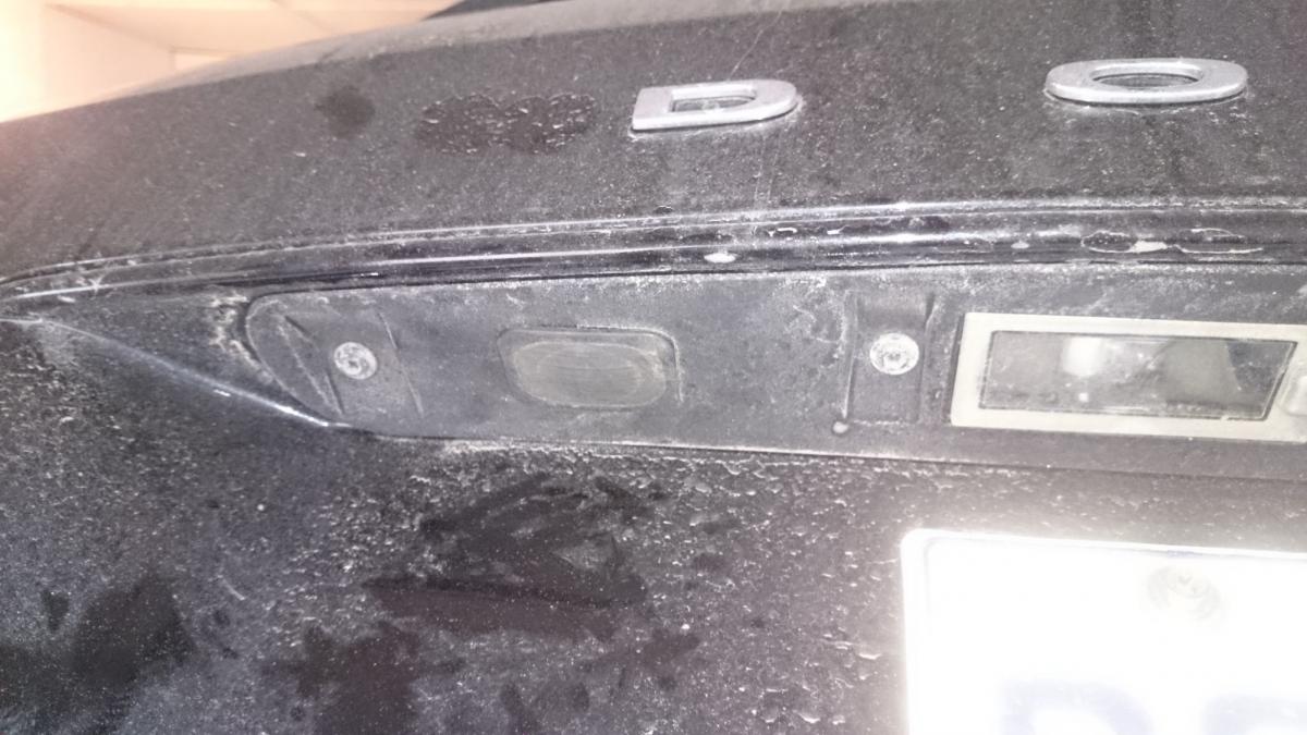

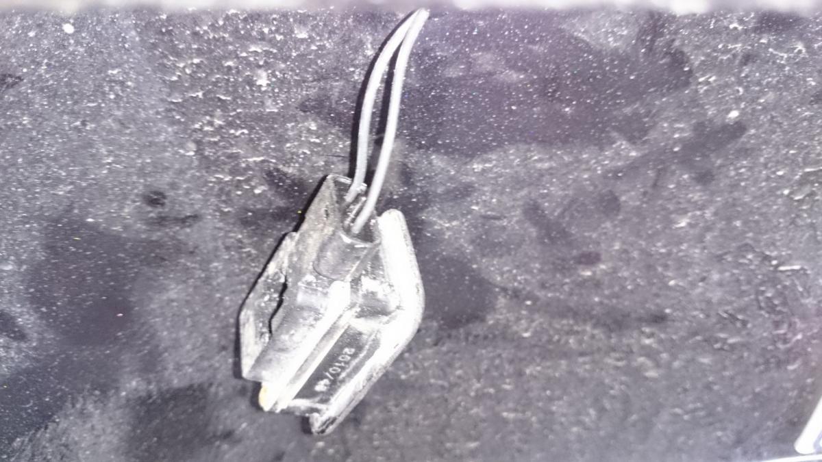

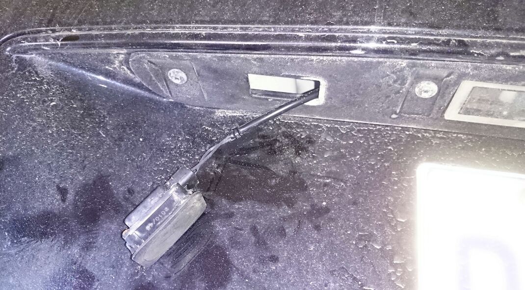

David Lebrun Posted April 25, 2015 Report Share Posted April 25, 2015 Hey guys, So I just got myself a used dodge journey 2011 RT and was wondering if I could add a backup camera & nav to it. I'll try and give you as many details about my journey as possible. It has the 8.4 screen with satellite radio. I noticed that it already has a plastic cover where the backup cam would normally be and by popping it out with a flathead screwdriver, I noticed that it's attached to 2 grey wires (photos below). Does that mean my journey is already pre-wired and I could just buy a camera, plug it in and it would work right off the bat? If so, do you have any suggestions about where I could get one? I would like to avoid having to bring it in to a dodge dealership because it's an hour away from where I live and I have two young kids.. if I could do this on my own it would be great. Otherwise, it's not that big of a deal, but I also know that they would charge me a ton of money. I'm in canada.. not sure if that changes things. Also, is there a way to find out if I have an 8.4A or 8.4N.. I heard that may change things as well. Thanks in advance for any tips you can give me!! Quote Link to comment Share on other sites More sharing options...
bigtsr Posted April 25, 2015 Report Share Posted April 25, 2015 Remote lock/open button for the hatch what you have pictured , as long as you have the key fob with you it will operate. Cameras are mounted at top center of plate. Quote Link to comment Share on other sites More sharing options...
David Lebrun Posted April 26, 2015 Author Report Share Posted April 26, 2015 That's weird because my key doesn't have a button for the hatch.. Quote Link to comment Share on other sites More sharing options...
David Lebrun Posted April 26, 2015 Author Report Share Posted April 26, 2015 ok I tried it and see what you mean. Could my car still be pre-wired? Otherwise, is it impossible for me to add a rear view cam? Also, how about nav? If I find an RB5 and swap would that work? Quote Link to comment Share on other sites More sharing options...
2late4u Posted April 26, 2015 Report Share Posted April 26, 2015 no they are not pre wired. check with your dealer using your vin they will tell you what radio you have. also check out the topics that refer to back up cams. cost is about $265 -305 U,S, for the cam and dealer install from $90. and up.. and from what i hear the navigation is more expensive and really not worth the cost and trouble.. check out the different topics in the forum for more info. Quote Link to comment Share on other sites More sharing options...
silenze Posted April 26, 2015 Report Share Posted April 26, 2015 With the car locked pushing that button on the hatch unlocks the doors. Quote Link to comment Share on other sites More sharing options...
bramfrank Posted April 26, 2015 Report Share Posted April 26, 2015 (edited) Backup CameraWhat you posted was a photo of the rear lock/unlock button that you've pulled out. If you have an '11 or later and an 8.4" display you can add a backup camera - if does not matter what version of the radio you have. I've included a link to the installation instructions, along with a couple of other threads on the topic at the end of this post below if you want to read up on it before making your final decision. No, the wiring is not in place, but it isn't hard to run. I added the OEM camera to my Crossroad - takes a few hours if you do it the way the kit suggests as I did, but it could take less if you get lazy and simply tuck the wiring under the panel edges and such, or as suggested you might go wireless, though I personally chose and recommend wired connections where the choice is available.No matter how you do it (wired or wireless) there is a sales code that must be flashed into the BCM by the dealer to enable the video display. The OEM camera kit replaces the entire panel that has that switch, the license plate bulbs, the manual release lever and the camera itself, which is located in the center of that panel. The panel itself, complete with the camera can be purchased for about $95 . . . the entire kit, with the cable harness is about $265. If you decide to install it yourself note that the simplest thing is to NOT take the power from up front, but to connect it to the rear 'cigarette lighter' socket located in the left side trim panel - it is a LOT easier to make the connection there than to extract the one in the instrument panel. The cost to flash the vehicle depends on the dealer, but they usually charge an hour or a half hour for the service. Since they were already charging me for an hour of labor I decided to use up that hour and had mine make the connection to the back of the radio because the pins to which the wires in question are supposed to go were occupied (which, if you think about it ought to have been for wires to a camera, since it IS the video input to the radio, but I tried to trace them before starting to run the wire and they do not seem to do to the rear of the vehicle).It works as expected. Navigation Adding nav is as simple as replacing the radio module with one that has the nav components inside - it takes all of 10 minutes to do and then you need to switch your Sirius subscription from the old radio to the new if you have the satellite service enabled. You need a subscription if you want traffic data, and for some reason Sirius Canada does not provide it, but the US division DOES. So you would cancel your Canadian service and sign up with the US - you would need a US reference address to get them to accept your order. Go figure. From a hardware perspective, since you have SiriusXM and an 8.4" display your vehicle has all the rest of the hardware required to install a nav radio - I did it on mine and so far have no complaints, though there are a few people out there with units that have had multiple issues (I have some thoughts on the subject as to why this might be) and there is no warranty when you do it yourself. Cost for the radio used varies from about US$600 to as much as $1400 (check out online sources) and $2,000 or more if you want to buy a new one. If you happen to be in the 514/438 area code you are local to me. Links Here are a few links about the backup camera installation for you to review . . . . . don't be intimidated by the photos in the second one and realise that he was also moving from a 4.3 to the 8.4" diaplay, it really isn't as bad as it looks - take it from someone who has done it himself: http://www.dodgejourneyforum.com/topic/6847-i-want-to-purchase-the-factory-navigation-system/?hl=%2Bbackup+%2Bcamera+%2Binstallation#entry48010 http://www.dodgejourneyforum.com/topic/6259-43s-to-84-uconnect-and-backup-camera-installed/?hl=%2Bbackup+%2Bcamera+%2Binstallation#entry42496 http://starparts.chrysler.com/info/default/K6861161.pdf Edited April 26, 2015 by bramfrank Quote Link to comment Share on other sites More sharing options...
