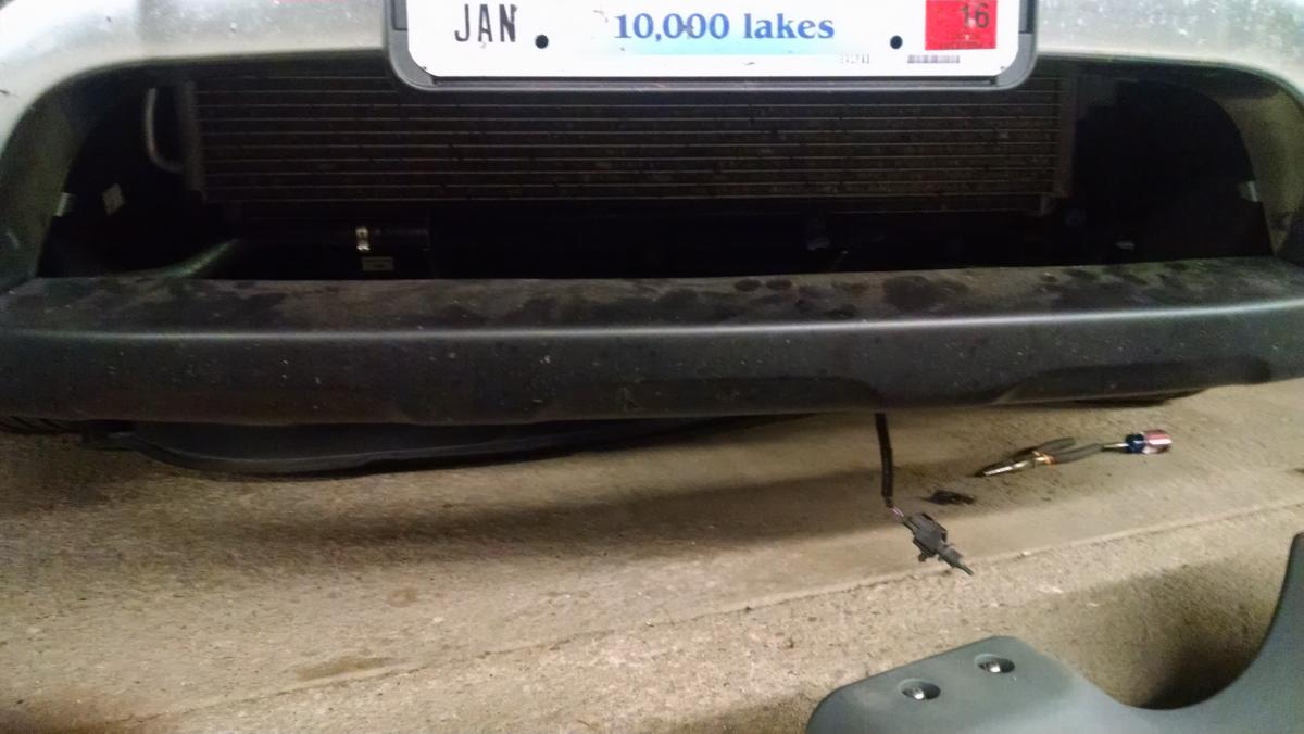

carritt11 Posted August 7, 2015 Report Share Posted August 7, 2015 (edited) Hi, I just want to ask how to remove front lower grille only? I already search this forum but there's no step by step instructions or is it just needed to pull out or something or I really need to take out the whole bumper. I do the research here and with google. so please dont tell me to search the forum, if there's one maybe I just missed it. Thanks!!! You do NOT need to remove the entire bumper. I have a 2015 crossroad but I imagine it's similar. All I did was remove the the plastic guard located under the bumper that's also attached to the fenders. Not sure what the actual name is. After that is removed I layed on the ground and reached behind the lower grille and pulled on one end and worked my way over. It was much easier than I expected. It's only held in by tabs Edited August 7, 2015 by carritt11 Quote Link to comment Share on other sites More sharing options...
carritt11 Posted August 7, 2015 Report Share Posted August 7, 2015 Removed lower grille with bumper still attached Quote Link to comment Share on other sites More sharing options...
