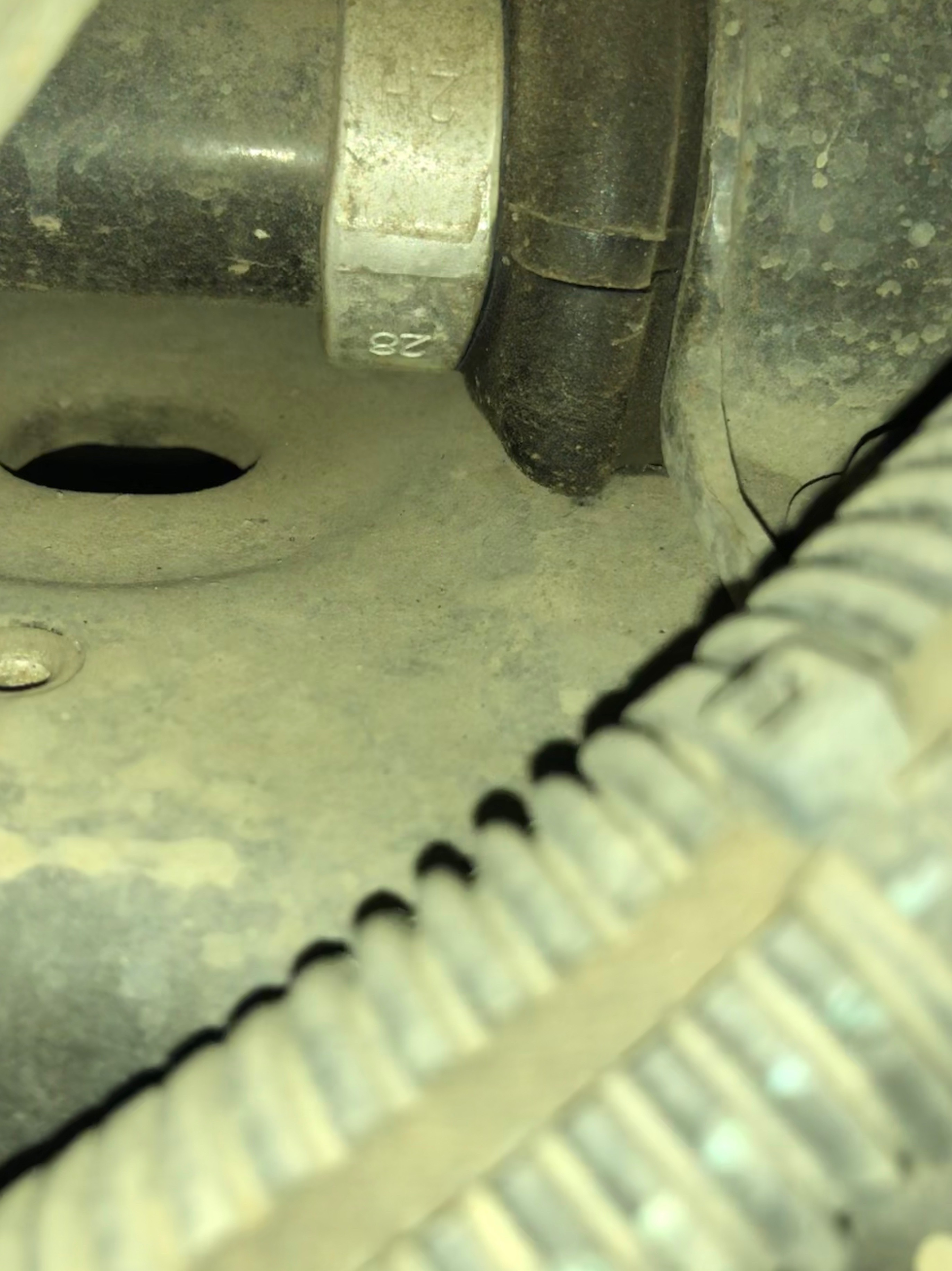

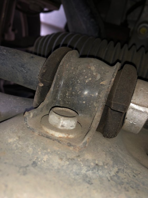

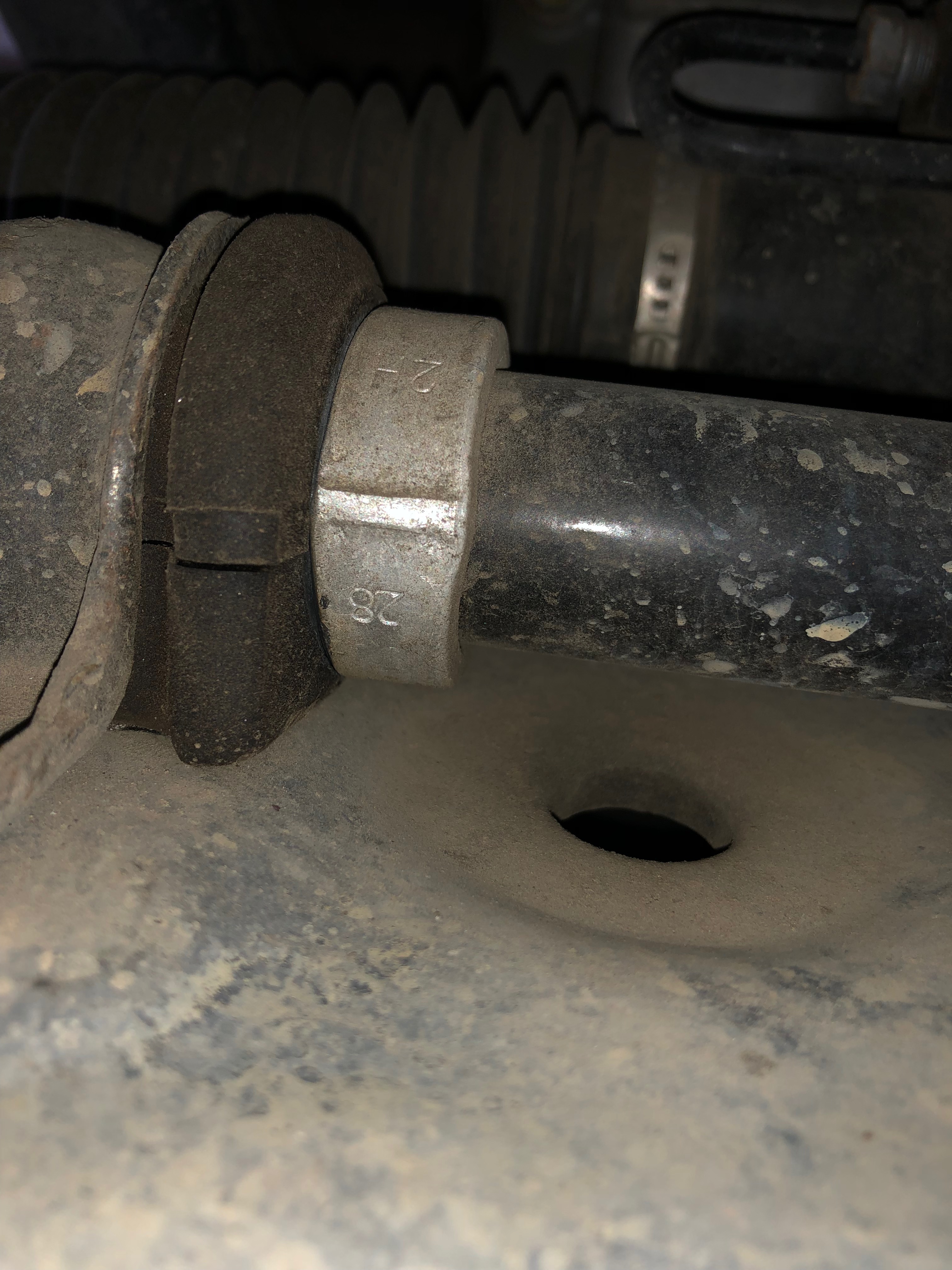

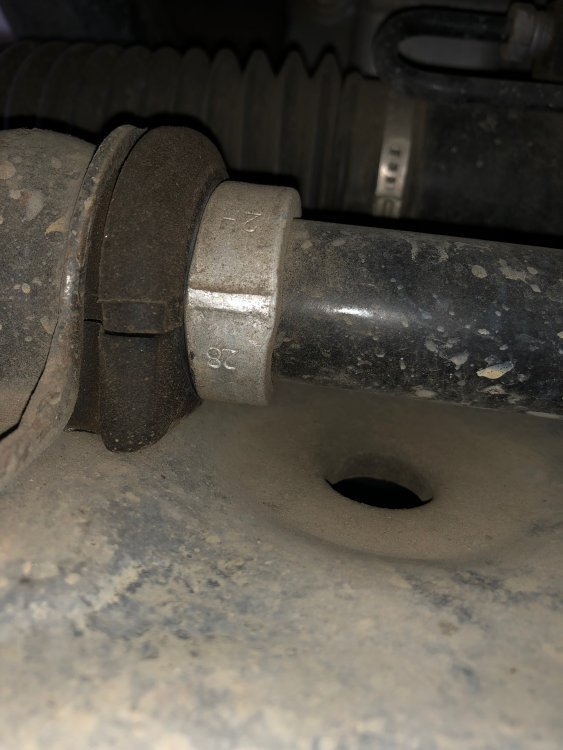

Randy e Posted May 13, 2019 Report Share Posted May 13, 2019 I have a 2009 journey 155,000 miles. SXT AWD. Had noise in front end for years. Replaced everything. Struts, lower control arms with bushings, lower ball joints, brake calipers, mount brackets, brake hoses, pads and rotors. Replaced stabilizer bushings and links. Tie rod ends still good. I finally figured it out. The stabilizer bar was hitting the crossmember on the inside of the mount. A retaining part of the bar is what was hitting. Made a 3/16 inch shim under the mounts and bracket. Had I aligned today and is finally like new. OhareFred, mechanical-idiot, Armando G and 1 other 1 3 Quote Link to comment Share on other sites More sharing options...
Jeremy Posted July 7, 2019 Report Share Posted July 7, 2019 @Randy e I've had this same noise with my Journey here in Australia. It's a 2013 and I got under it today to look at what you have mentioned. Does mine look the same as yours as there seems to be enough clearance and no signs of rubbing?? Quote Link to comment Share on other sites More sharing options...
