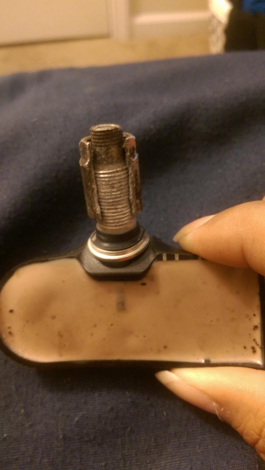

I've had the vehicle for one week and today my low tire indicator light came on. I went outside and checked all the tires. The day I was taking the vehicle off the lot and purchased it which was a week ago I was told that all the tires we're checked for correct pressure. So what my indicator light came on I was a little concerned it's only been a week. I took my tire pressure indicator and found that the front driver side tire was 52, front passenger tire was 42 pressure, the back passenger tire was 22. And I tried to check the back driver side tire but I could not unscrew the cap. So I decided to drive the truck the oil change place that I usually go to. I explained to him that I couldn't get the cap off the back driver side tire and asked if they could assist me and of course they did. He also tried to take the cap off and it would not come off so he went and got pliers and when he pulled it off the stem came off and the tire went flat on the air came out. Luckily they were able to put a new staff in there and it only cost me $18. But my issue is why were all the tires pressure completely off. I was told that these metal stems do this often and I shouldn't ask them to replace them with plastic stems. Also also the metal screw part broke off which was not the faults of them. You could tell it was already corroded and I bet the other ones are too. I did purchase the extended 3 year warranty bumper to bumper. So should all this be covered under the warranty? But even if I didn't have a warranty I've only had the car a week all these repairs should be done free of charge or am I wrong?

The TPMS sensors with integrated valve stems Chrysler used on MANY vehicles in 2009/2010 are terrible. They are cheap aluminum, they will corrode, and they will break. Even better - the OEM sensors have no means of removing the valve stem. You have to go aftermarket if you want the ability to just replace the stem while keeping the sensor.

Edit: To be more accurate - there are 4 pieces to that valve stem/pressure sensor. There is the pressure sensor and integrated valve stem (the part containing the transmitter and batter, and the aluminum valve stem that comes out of it - yours broke about 5/8 of an inch from the tip), the valve core (the pin which actually seals the valve when pressurized aire is behind it (ie, inside the tire), the valve stem nut (yours ripped open down the side) which is used to secure the valve stem/sensor to the wheel, and the valve stem cap (should be plastic, keeps gunk out of the opening of the valve stem you would use to add or remove air). You COULD use an aluminum cap, but plastic is fine.

Because the valve itself was already corroded and weak. I have a 2010 Town and Country* that had the same problem. 3 out of the 4 valve stems broke within a month of me buying it used in 2011.

No, they do NOT corrode if you use the caps that come with the vehicle they are made of the same metal as the stem and the nut. There is even a warning in the LHS manual about that (can't speak for the 2010 Journey). But that picture shows the nut that holds the valve assembly in place has being cracked and the stem is corroded. I suspect the caps were not the originals.
To prevent this sort of thing you can have the nuts removes and coat the threads with anti-seize.

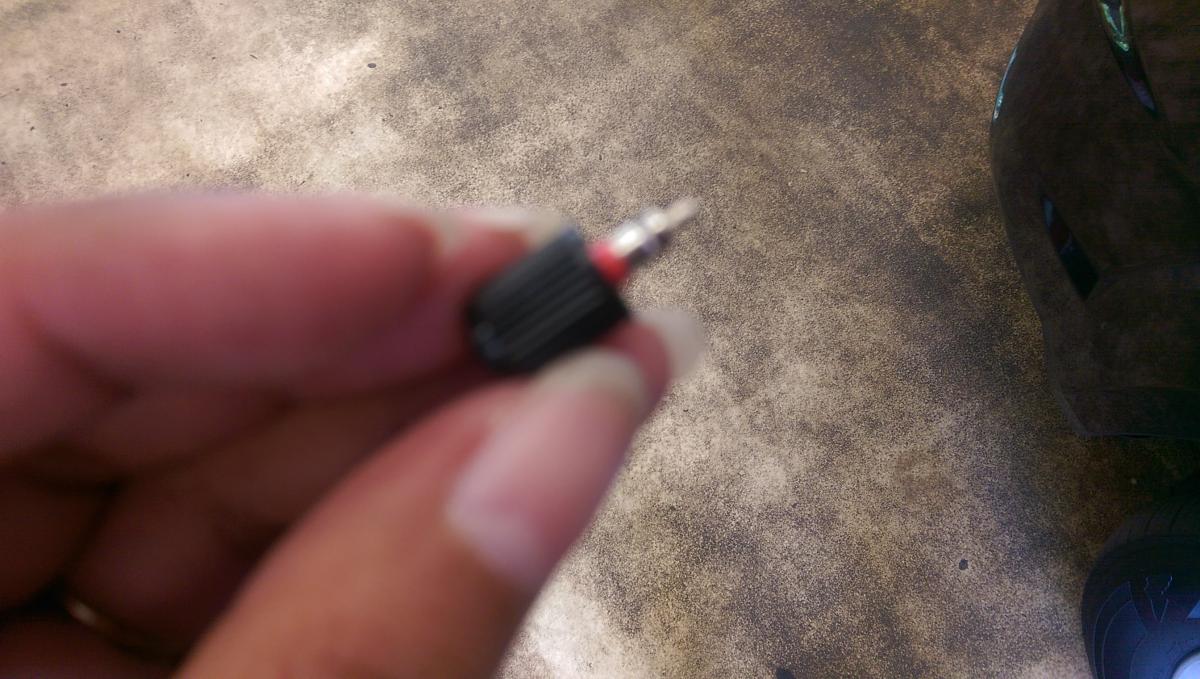

When I purchase the vehicle a week ago it did not come with any caps except one of the tires which is the one that the stem came off of today. I did not notice there was no caps until a day later when I brought the vehicle home. I didn't think much of it so I went to the store and just purchased the black plastic caps. And today my tire pressure indicator light came on which is why I took the car to the oil change place to help me unscrew the cap on the one tire that it did have a cap that I couldn't get off.

That is a plastic cap, exactly as it comes shipped from Chrysler's supplier. A Chrysler dealership replaced 3 of mine, and the 4th I paid a shop for, and they ordered from a Chrysler dealership. The stock part is plastic.

You're within 1 week of purchasing a used vehicle, so it depends on how much that dealership wants to do business with you in the future. I would ask for replacement TPMS modules on the remaining 3 wheels - ESPECIALLY if they show signs of corrosion. Before you go, GENTLY clean them with automotive soap and water and a soft cloth (don't use anything more abbrasive than a hand towel). If they appear black after that, that is a sign of possible corrosion. A replacement TPMS will have all the necessary parts.

On ebay, there is a set of plastic chrome valve stem covers with the Mopar M on the top. Everywhere I go, people ask me where I got them. Put plastic caps on all of your stems and you will solve this problem. This problem has been going on ever since Mopar has installed TPMS..I had this problem on my 2003 Liberty Renegade and my 2006 Commander; it has gone back that far. You can only use plastic valve stem covers.
