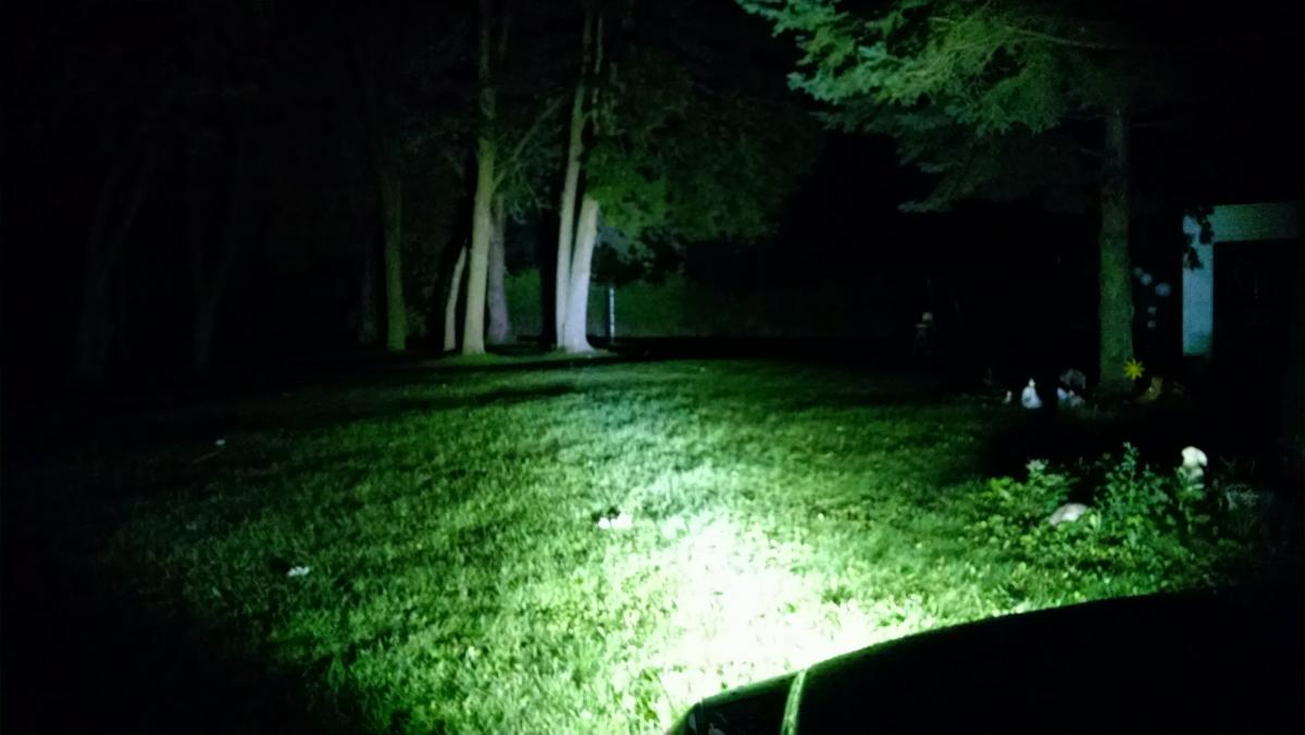

Lobitz68 Posted August 7, 2015 Report Share Posted August 7, 2015 Nice job. Curious about how much light output you get on the dark back roads... Post some pics if you can. dhh3 1 Quote Link to comment Share on other sites More sharing options...

carritt11 Posted August 7, 2015 Author Report Share Posted August 7, 2015 I'll try to get pictures when I can. I tried to get a picture of the light cast compared to headlights in a darker are but my camera on my phone only picked up as far as the headlights. It couldn't focus past that. The bar itself is nothing fancy. Just a cheap China bar I got off eBay for $50. I figured I wouldn't really use it too much so I didn't want to buy the really good ones. It's rated at 8400 lumens. It has epistar led chips. dhh3 1 Quote Link to comment Share on other sites More sharing options...
carritt11 Posted August 20, 2015 Author Report Share Posted August 20, 2015 Headlights LED Light Bar Headlights and light bar FlomotionJourney, Woah322, dhh3 and 1 other 4 Quote Link to comment Share on other sites More sharing options...
Lobitz68 Posted August 20, 2015 Report Share Posted August 20, 2015 Took long enough!! Looks good. dhh3 and jkeaton 2 Quote Link to comment Share on other sites More sharing options...
