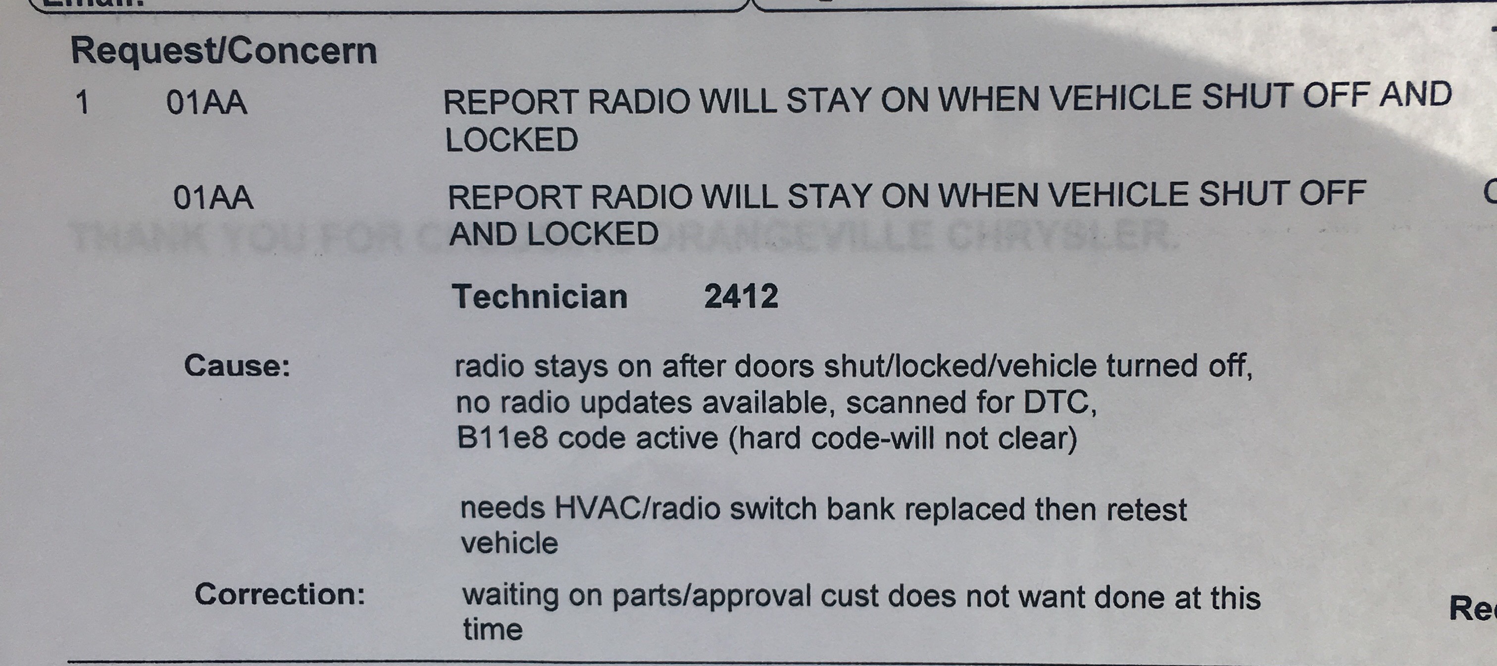

My Journey Posted May 17, 2018 Report Share Posted May 17, 2018 Hello, I herd back from the dealer, they are saying it’s a faulty HVAC/Radio switch bank. I have never herd of this before. Maybe someone can help shed some light on what it is or where it’s located. They quoted me what I think is too expensive, I’m going to try and source the part and then do the repair myself. I attached the image from the dealer report. Quote Link to comment Share on other sites More sharing options...

ChrisPollard Posted May 21, 2018 Report Share Posted May 21, 2018 I had this issue with our 2012. They ended up completely replacing the stereo under warranty. It was a defect in the unit ... which of course includes all the HVAC controls too, so you can't even put an aftermarket stereo in these things. Quote Link to comment Share on other sites More sharing options...
