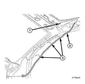

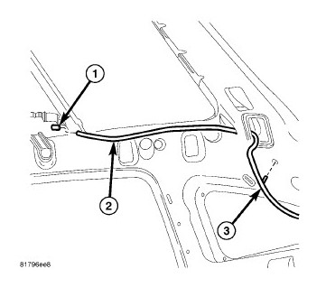

Scotty in NZ Posted September 21, 2017 Report Share Posted September 21, 2017 Looks like there are Front (A Pillar?) & Rear (C Pillar) drain hoses. 1) Remove Headliner... 2) Front Hoses - Disconnect the front hoses (2) from the sunroof assembly (1) - Release the support clips (3) and disconnect the lower grommet and remove the hose. 3) Remove Rear Hoses - Disconnect the rear hoses (2) from the sunroof assembly (1) and release the support clips (3). Link to comment Share on other sites More sharing options...
