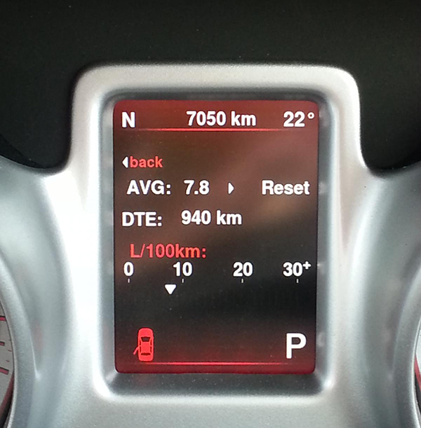

gui0407 Posted October 6, 2015 Report Share Posted October 6, 2015 Hi everybody, first topic here ! I have a 2011 sxt and whenever I stop, in D or P, the consumption bar goes all the way to the top and in red. This picture I got from another post here and how I think it should be And this is how mine is, parked, 0 Km/h, not acelarating... Any tip on what I should check ?? Thanks a lot dhh3 1 Quote Link to comment Share on other sites More sharing options...
jkeaton Posted October 6, 2015 Report Share Posted October 6, 2015 Check nothing. It's saying you are at max mileage since there is no load. Maybe someone else has a different take, but I wouldn't worry about it. dhh3 1 Quote Link to comment Share on other sites More sharing options...
redtomatoman Posted October 6, 2015 Report Share Posted October 6, 2015 Something is not right. If I understand correctly, you are not moving. If the engine is running and you're not moving, then you can't be at max efficiency. In fact, that's the worst possible scenario. Get it checked. Peace. dhh3 1 Quote Link to comment Share on other sites More sharing options...
bramfrank Posted October 6, 2015 Report Share Posted October 6, 2015 He's set in metric. It is litres/100 km - full scale is correct (infinite fuel/100km when not moving). If he sets it for MPG it will sit to the left when not moving (0 MPG). dhh3 and jkeaton 2 Quote Link to comment Share on other sites More sharing options...
redtomatoman Posted October 6, 2015 Report Share Posted October 6, 2015 Ahhh. Right. Now I get it. Peace. jkeaton and dhh3 2 Quote Link to comment Share on other sites More sharing options...
jkeaton Posted October 6, 2015 Report Share Posted October 6, 2015 So, I was right.... dhh3 1 Quote Link to comment Share on other sites More sharing options...
