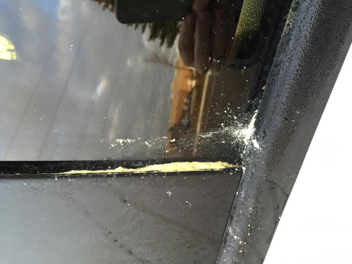

Johnbednar Posted October 28, 2015 Author Report Share Posted October 28, 2015 Vandalism confirmed this morning after a little time behind a row truck.... Any ever heard of a gas tank filled with a fire extinguisher?..... So bizarre, repair estimate just below $4000, and obviously not cover under warranty. Poor thing barely had 300km on it.... Last pic is what I thougt was an egg.... dhh3 1 Quote Link to comment Share on other sites More sharing options...
bramfrank Posted October 28, 2015 Report Share Posted October 28, 2015 (edited) Well, that sounds like the basis for an insurance claim . . . . and get out and buy a locking gas cap before you put the vehicle back on the street.$4K sounds like a awful lot of money to clean out the fuel tank and possible replace the fuel lines . . . but that's just me.If the vehicle is in visual range of your place at night you might want to consider buying a camera and recorder to watch the vehicle and record what goes on . . . . . you can check the video quickly if the device has high speed playback abilities (you can review an hour of video in under 8 minutes at 8X) and many of these systems can detect, list and advance to movement events at the click of a mouse, making the review process really painless.Obviously a morning walk-about is going to be a daily requirement until you can figure out who the culprit is.Wondering though about that 'gas gauge went to zero and back' report, however.Good luck Edited October 28, 2015 by bramfrank Quote Link to comment Share on other sites More sharing options...
OhareFred Posted October 28, 2015 Report Share Posted October 28, 2015 Oh man, I feel for you! That looks like ABC extinguisher powder. Not just you gas tank, but all fuel lines and injectors will need to be cleaned or replaced. Not to mention the damage to your top end. Get a police report and document this. If they ever catch the basterds you can go after them for $$ ( at least here you can). That powder is corrosive to aluminum parts and canget into everything and everywhere, as well as getting like concrete. Not funny at all. Best of luck.... jkeaton and dhh3 2 Quote Link to comment Share on other sites More sharing options...
