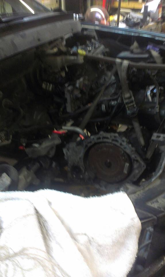

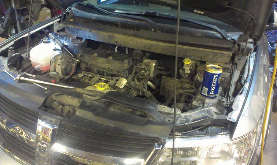

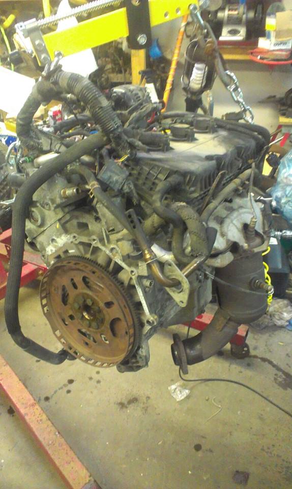

casey sohc Posted November 9, 2015 Report Share Posted November 9, 2015 (edited) Hi there i am a newbie here and i just did an engine swap in my journey ...what a pain to do...i was lucky enough to find another 09 journey engine ..i had some issues changing it but nothing too major.there are a few engines that fit and are the same....i was told by the scrap yard that only the journey and sebring were interchangable... i changed ours because it was going through 6 liters of coolant a week, and between 3 to 5 liters of oil between oil changes...i thought we could get more than 172000km out of it...but nope. surprisingly the engine will come out through the top ...and is a complete bugger to change.and for everyone who are having multiple misfires and and poor performance and stumbling aparently these are known for cracking heads and intakes, the exhaust valves are all chalk coloured white from running on coolant. Edited November 9, 2015 by casey sohc dhh3 1 Quote Link to comment Share on other sites More sharing options...

casey sohc Posted November 9, 2015 Author Report Share Posted November 9, 2015 this is the 3.5 liter v6 and it had issues from the get go..it would knock and make noises sometimes at start up ( not every time,) like it was low on oil...or flat lifters..if you shut it down and started it 3 times the noises went away...i think it suffered from tourettes..it loved oil sometimes ingesting 4-5 liters between changes. but the last straw was the drinking of antifreeze, it broke the coolant bottle,i tried to fix it...nope $89 for a new one then it started overheating and then we purchased another engine that is certified for 3 months unlimited mileage from the auto recyclers. dhh3 1 Quote Link to comment Share on other sites More sharing options...

Borjawil Posted June 3, 2020 Report Share Posted June 3, 2020 Casey, shot you a pm to see how you pulled it from the top and how you did so while.leaving the trans in. Trying to drop my engine through the bottom and leave the trans but whatever works. Quote Link to comment Share on other sites More sharing options...
jkeaton Posted June 3, 2020 Report Share Posted June 3, 2020 11 hours ago, Borjawil said: Casey, shot you a pm to see how you pulled it from the top and how you did so while.leaving the trans in. Trying to drop my engine through the bottom and leave the trans but whatever works. He has not been active on this forum for 5 years. Quote Link to comment Share on other sites More sharing options...
Borjawil Posted June 4, 2020 Report Share Posted June 4, 2020 He sent me a pm. But I figured it out. In my other post on how to pull engine. jkeaton 1 Quote Link to comment Share on other sites More sharing options...
