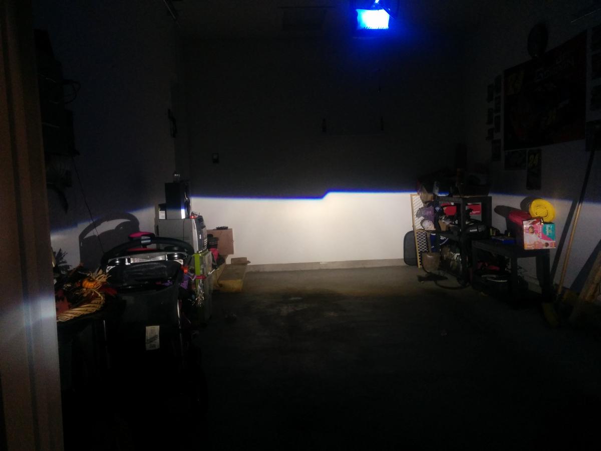

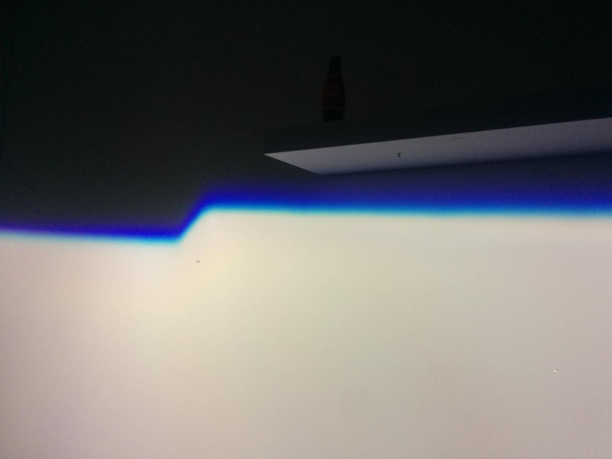

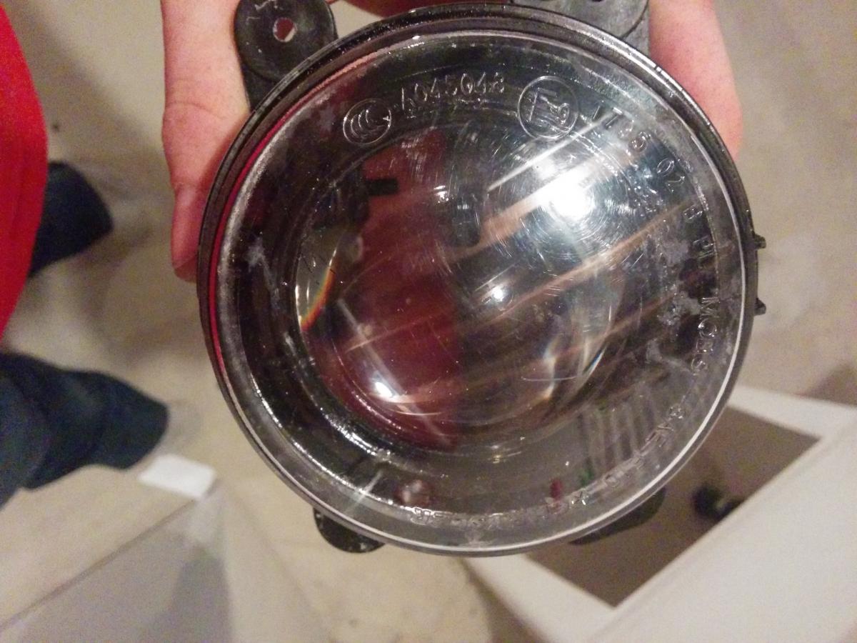

Cody Chornobey Powley Posted January 15, 2016 Report Share Posted January 15, 2016 I used a mini h1/6.0 in my fogs and h1/7.0 in my lows, it acts as both hi and low same with the fogs, the pic is the 7.0 cut off and a output shot of the foglights. Building the headlights over the weekend finally Lobitz68 1 Quote Link to comment Share on other sites More sharing options...
bramfrank Posted January 15, 2016 Report Share Posted January 15, 2016 A proper projector, that . . . well done. Cody Chornobey Powley 1 Quote Link to comment Share on other sites More sharing options...

Cody Chornobey Powley Posted January 21, 2016 Report Share Posted January 21, 2016 Over 100 feet away with hid projectors, I bet with those led you get maybe 50-60 feet of distance 11journeybama and Lobitz68 2 Quote Link to comment Share on other sites More sharing options...

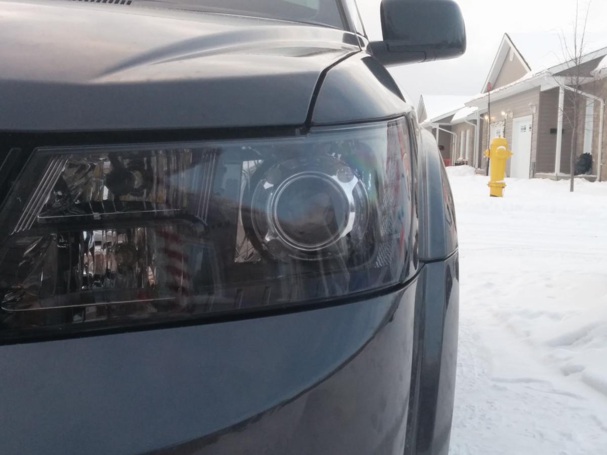

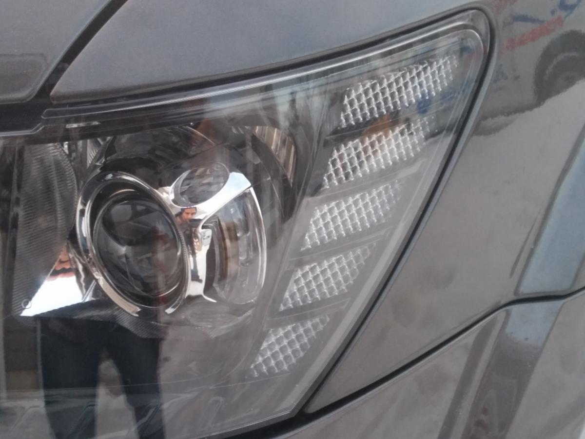

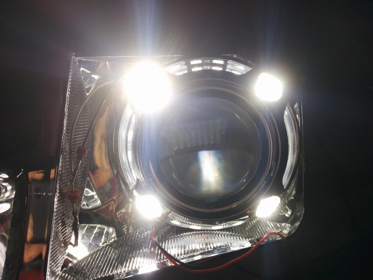

Cody Chornobey Powley Posted January 21, 2016 Report Share Posted January 21, 2016 This is what you want for performance. Lobitz68 1 Quote Link to comment Share on other sites More sharing options...
Devilzblood Posted January 21, 2016 Report Share Posted January 21, 2016 This is what you want for performance. Yup, I can't agree more. Did you do this yourself? I live in the TO area and I am afraid of messing other things up so looking to see if I can find a shop to do this. The only problem with them is that I don't know how reliable the projectors will be. I got a quote of 350 with Halo lens projectors for the journey. The shop would need the car for the day to do the retrofitting. Quote Link to comment Share on other sites More sharing options...

Cody Chornobey Powley Posted January 22, 2016 Report Share Posted January 22, 2016 Yeah buddy. This is my 5th set I've done. Second on the journey, I did a set on my elantra, my 91/Sierra and a 2015 ram Yup, I can't agree more. Did you do this yourself? I live in the TO area and I am afraid of messing other things up so looking to see if I can find a shop to do this. The only problem with them is that I don't know how reliable the projectors will be. I got a quote of 350 with Halo lens projectors for the journey. The shop would need the car for the day to do the retrofitting. 11journeybama 1 Quote Link to comment Share on other sites More sharing options...
Cody Chornobey Powley Posted January 22, 2016 Report Share Posted January 22, 2016 What kind of projectors did he quote you with? 6.0 are great and same with md2s. Quote Link to comment Share on other sites More sharing options...
